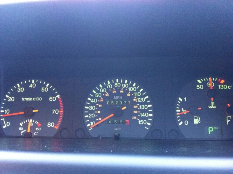

Distance covered today: 460 miles exactly
Range left in tank: 247 miles
Average Economy: 30.7mpg
Average Speed: 59mph
After arriving home there's still 1/3 a tank left in the car
Picture below to prove:

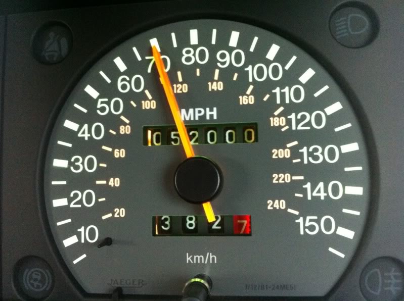

My XM also reached a milestone on the way home today too
