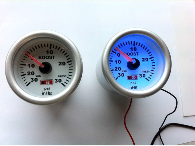

I'm thinking of trying to locate the boost gauge in the storage bin in front of the gear lever, just as a temporary measure whilst setting everything up. What's the best way to get a small pipe from the bulkhead into the passenger compartment within the car?

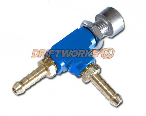

That looks like a Pressure Relief Valve. For a smooth boost top your best to fit a Pressure Bleed Valve as it doesn't then overspike as much IMO.
As for mounting the boost gauge i'd aim for somewhere higher up if possible, maybe one of the A pillar pod things but just 3m padded on a little to keep it in place so as easy to remove later on?

Hmm, I read the opposite on the netKP wrote:For a smooth boost top your best to fit a Pressure Bleed Valve as it doesn't then overspike as much IMO.
