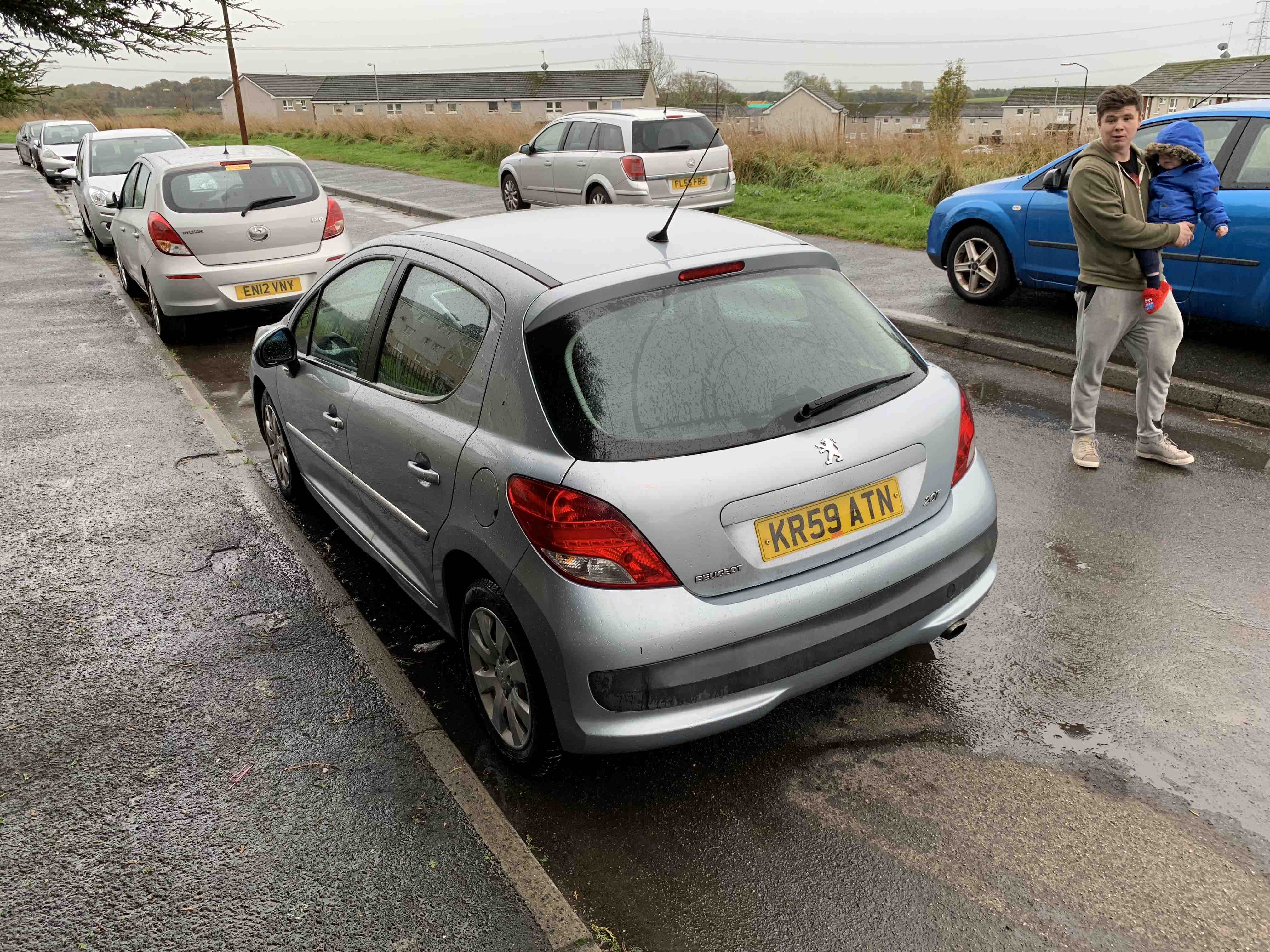

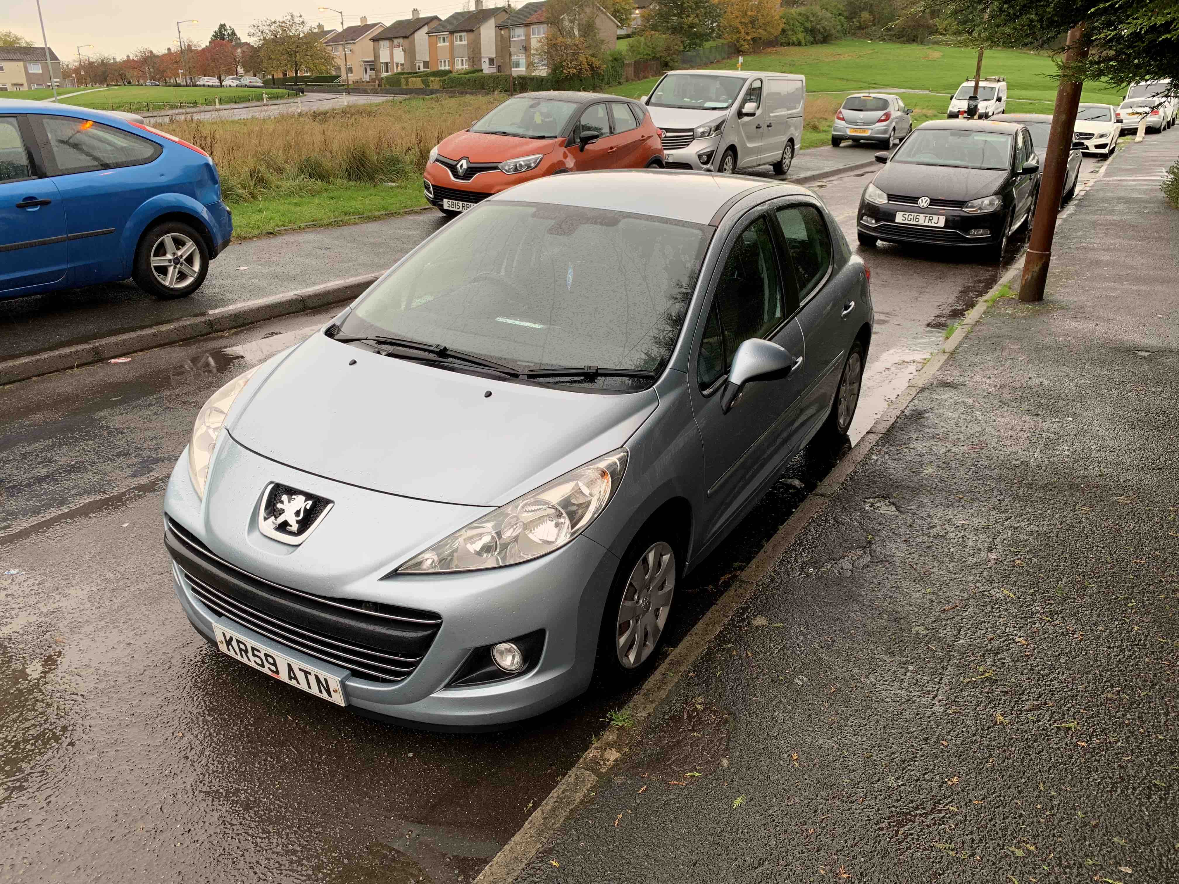

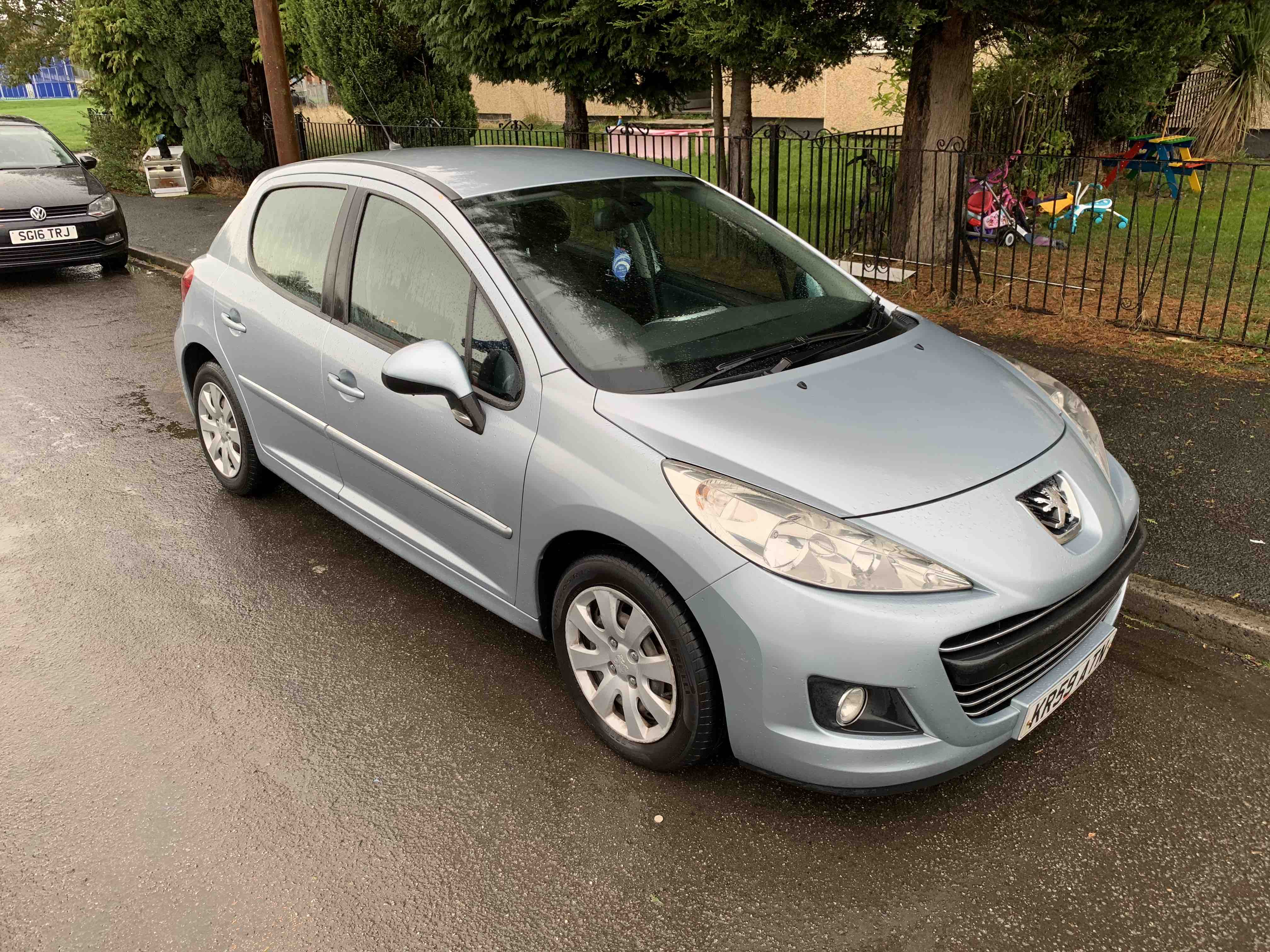

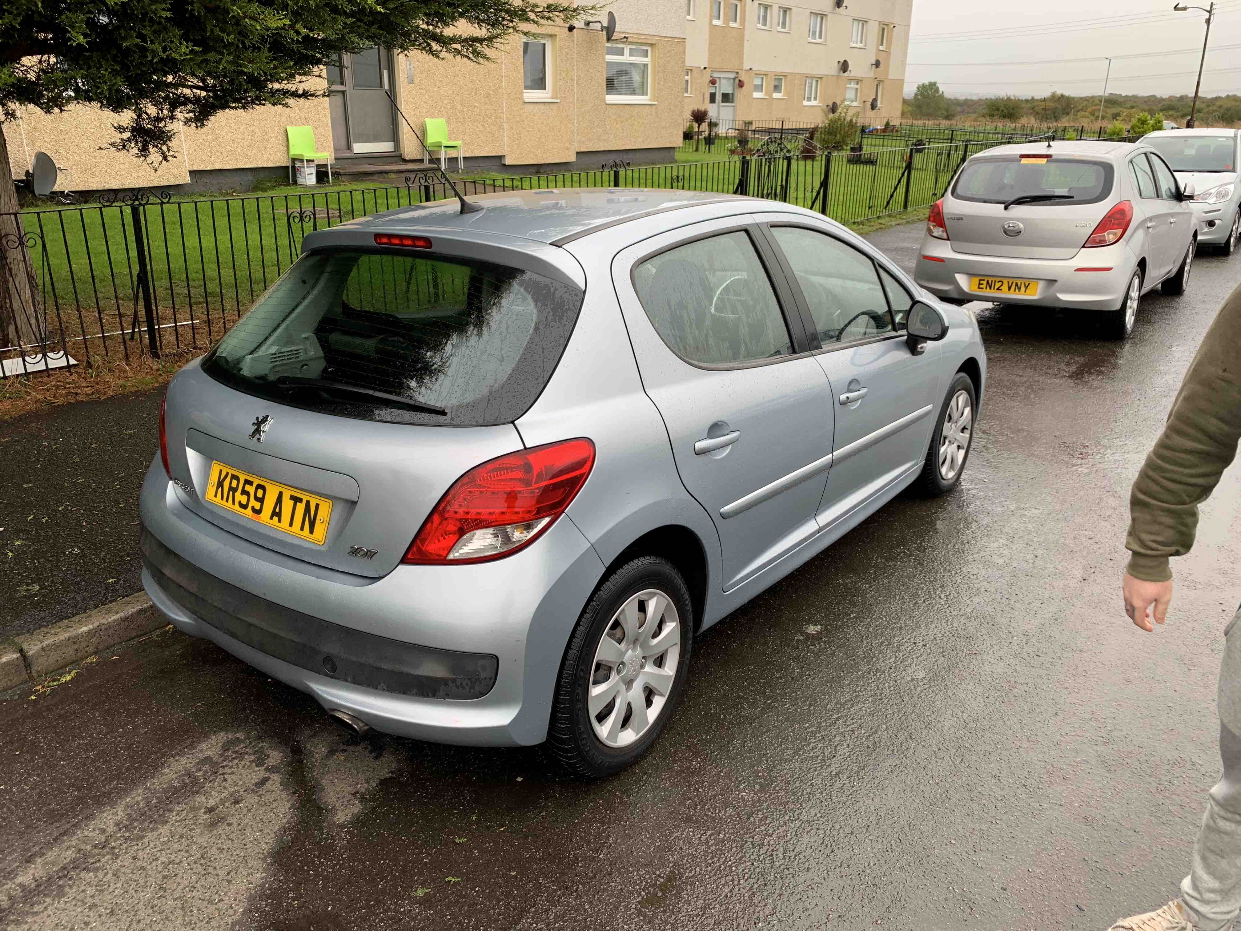

I found a 207 HDi on Gumtree in Glasgow so went to see it this evening. It's a 1.6 HDi and seems to run and drive very well, it's a bit smokey under hard acceleration but it's black diesel smoke and the last owner was elderly so I'm hoping some injector cleaner and a thrash will sort that out.
Plan is to fit cruise control which is a 10 minute job, fit leather and then when the tyres need changing I'll stick some alloys on it for her. Other then that it's a really nice little car.

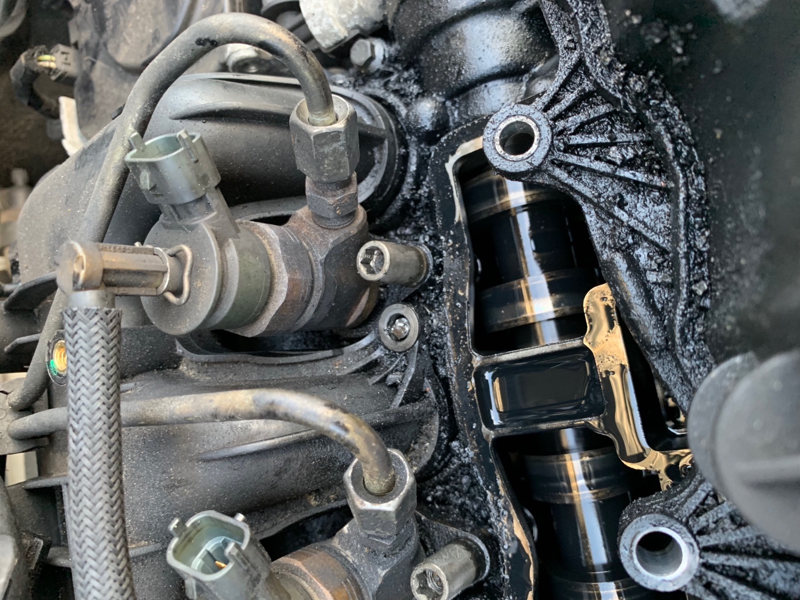

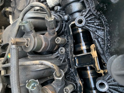

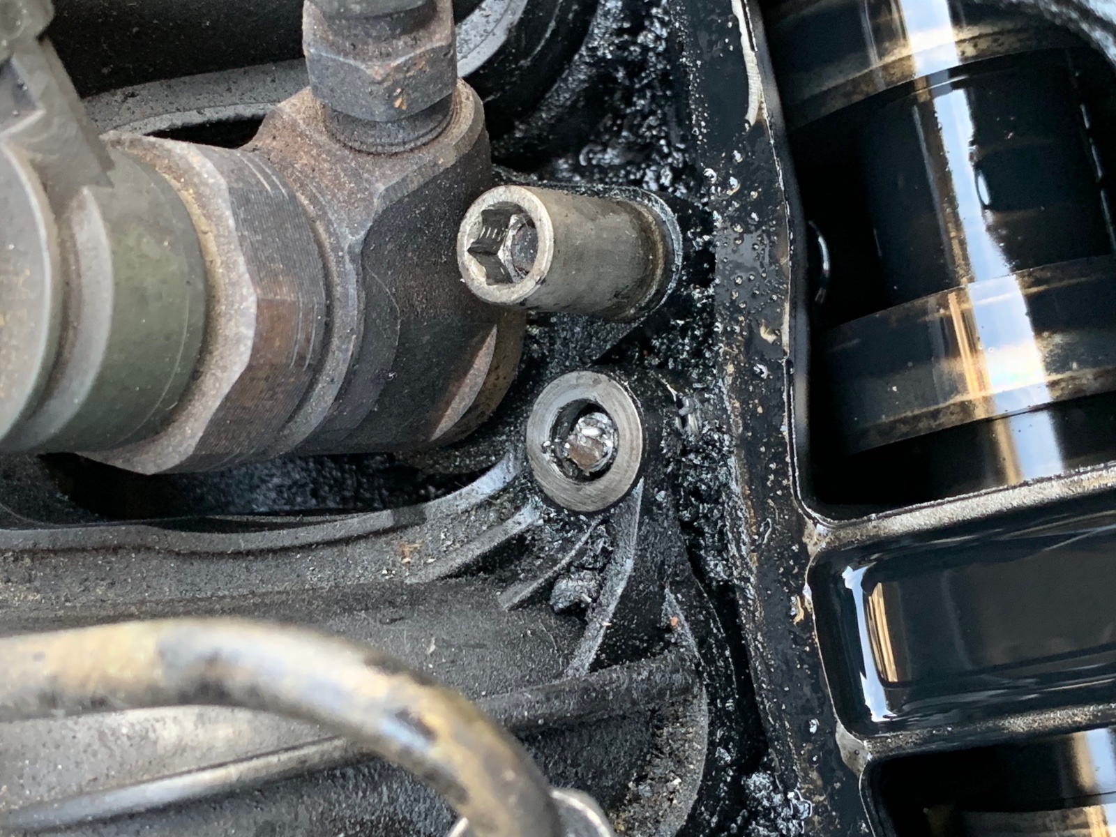

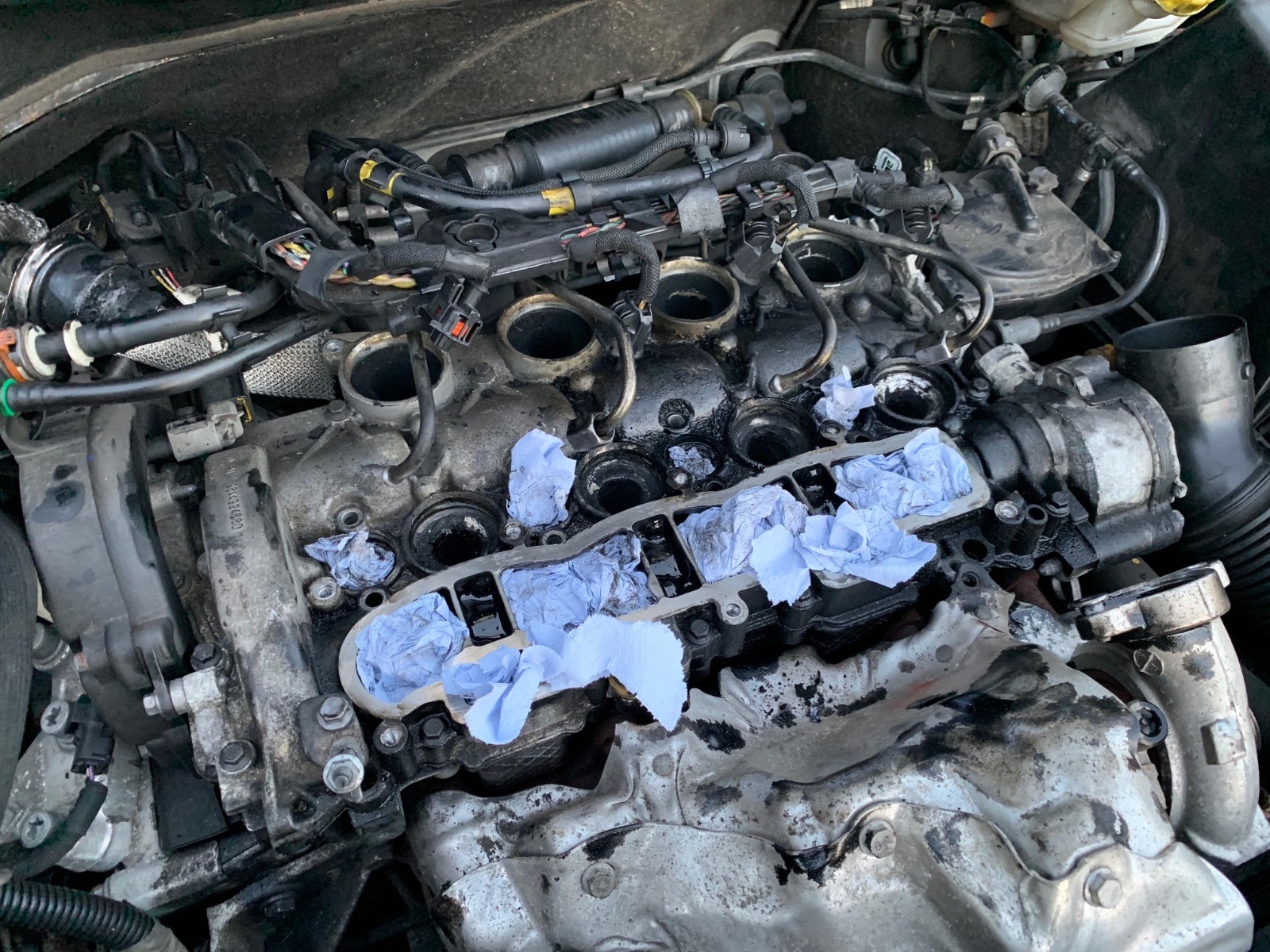

Evening gents,
Not sure where to post this as it's Citroen and Peugeot related so I went for here
I'm doing a few jobs on the 207 HDi at the moment and have stripped the rocker cover, inlet manifold and injectors off the engine. There was an oil leak from the rocker cover caused by a sheered bolt, unfortunately it was one of the bolts that goes through the inlet manifold too so I've got it all stripped and managed to get the snapped bolt out.
I've read about the injector studs being stretch bolts too so I've removed all of those too. Thankfully none of them sheered which was really worrying me. There's little inverted torx heads on the studs to remove them, all bar 2 of them undid with the right socket, 2 of them needed mole grips to undo them but they all came out perfectly.
Everything was absolutely filthy due to the oil leak which looks like it's been leaking for an awful long time...
I've been sat tonight with a tin of degreaser and a paint brush to clean everything off and it looks a lot better then it did before.
I'm absolutely amazed at how disgusting modern diesels get with all this EGR crap that's bolted onto them... The inlet ports on the manifold and on the engine were probably 1/3 - 1/2 the size they originally were with carbon stuck solid to them. I scraped it all off the manifold and blew it out with the airline, I then got the industrial hoover and held it above each port on the engine as I scraped it out of there too. I then blew down each cylinder with the airline to clear them too.
The injectors in the 2 cylinders around the gearbox were covered in thick oil for the entire length of the shaft so I'm glad I'm sorting this leak once and for all. Interestingly, all 4 of the back injector clamps were loose so I'm glad I'm replacing all of the bolts and studs to get everything torqued down properly. I also noticed that on the bottom of one of the injectors was 2 copper washers which really narked me.
I'm glad I'm giving it a going over as I'm hoping now that it's going to be reliable and sorted once it's finished.
I just need to find torque values from somewhere to put it all back together now
David.

- Posts: 52827
- x 7251
Re: All Things V6 & a Turbo!
A long-term oil leak in a new-ish car points to very poor routine servicing... You'd have thought the people doing the servicing would have alerted the previous owner to this problem...
Maybe they did and the cost of rectification was just too great... Does the car have a recognised service history David?
I find it quite amazing that this problem should still remain in a modern engine... Expected in an XUD but in a modern HDi it's really quite unforgivable...
DHallworth wrote: 17 Oct 2018, 21:25
A filthy Peugeot
looking at the modern egr and your photos are the rear holes and middle holes next to the injectors linked by the intake manifold with some 'egr trickery' inside the manifold
I assume this is why the modern engine benefits from a TerraClean type of service at least your way you get to see the result of an intake de-coke
David
