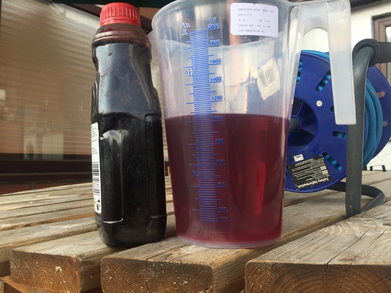

Right, work began on my newly acquired C5 tonight. I started by giving it a good service, oils, filters etc. and then progressed onto changing the gearbox oil. Citroen claim this box is sealed for life but after I felt it tug once or twice between gear changes I thought I'd best do something with it.
I got fluid from Euro Car Parts, ATF Plus, on the bottle it says it's compatible with AWS3309 which is the proper fluid for this box so it should be fine. Unfortunately you can't do a full change on it so you have to do 3 x 3 litre changes. I did the first of the 3 this evening.
I poured a litre of the old stuff into an old screen wash bottle so you can see the difference in colour:
This car has done 95k and it looks like the gearbox oil has never been changed in that 95k! The old stuff that came out was almost black in colour and was very thin, almost like water. The new stuff was a bit thicker when it went in. I took 3 litres out and put 3 litres back in, then reset the oil counters with Lexia and took the car for a quick run, the difference in the gear change is immediately noticeable, I didn't feel it tug once, I didn't go very far though.
So... make sure you change your gearbox oils...
David.
David.
