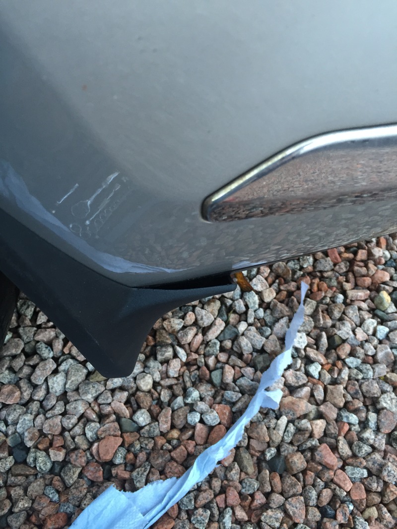

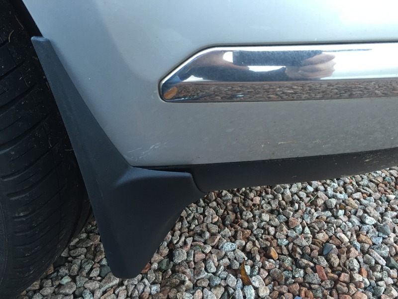

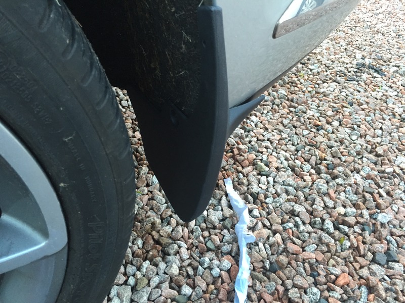

I did a trial run with one of the mud flaps on Sunday afternoon but just couldn't get it to sit right. It sat fine along the bumper edge and along the bottom but there was a bit of a gap behind the flap:

Yep, my mud flaps do the same, heat gun on the radius area (only) and it bends back a bit.....Xantia ones fit the front btw

Strange that the mudflaps wont fit, they're definitely for the saloon?
It sounds like quite the wolf in sheeps clothing! I be its an effortless cruiser, its a rare thing too!

They're the correct part numbers on the box for the saloon. They're a perfect fit in every dimension apart from the gap you can see

A small self tapper on the very underside David, it pulls them flat
