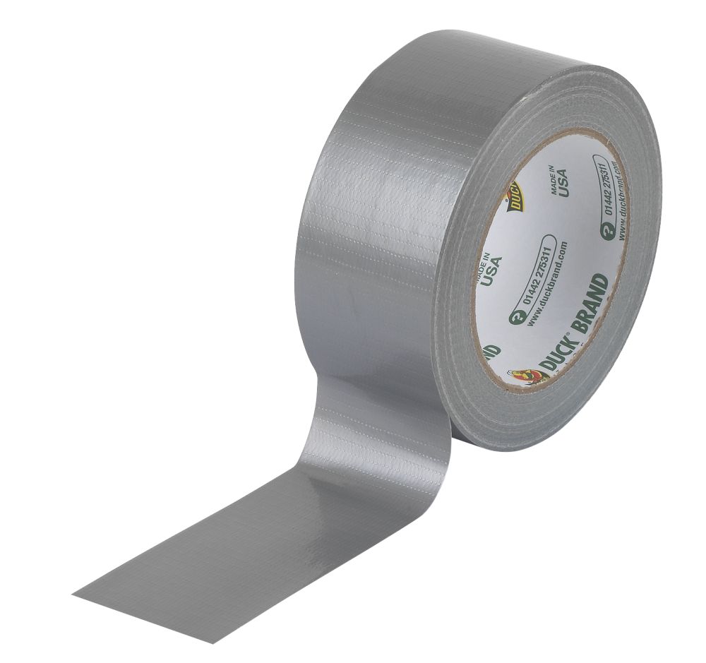

That was done last year when the car was BL Auto's, Jim. Thankfully it's been stuck on with double sided tape this time rather then being bonded so it'll come off without any problems
I'm tempted to try RichardW's suggestion of using some duct tape though

The big problem will be getting all the way round it David but even partially sealed is going to be better than what you have now...DHallworth wrote: I'm tempted to try RichardW's suggestion of using some duct tape though![]()

Better....as the adhesive does not breakdown with heat/moisture
Polytunnel Tape.

It makes the dashboard a bit hard to get apart later though if you tape everything together!
I would try getting some thin foam tape with a sticky back, and only cut off half the backing, lengthwise - that way you can stick it to one half of the joint but it will not stick to the other half - just like the original foam sleeves.
