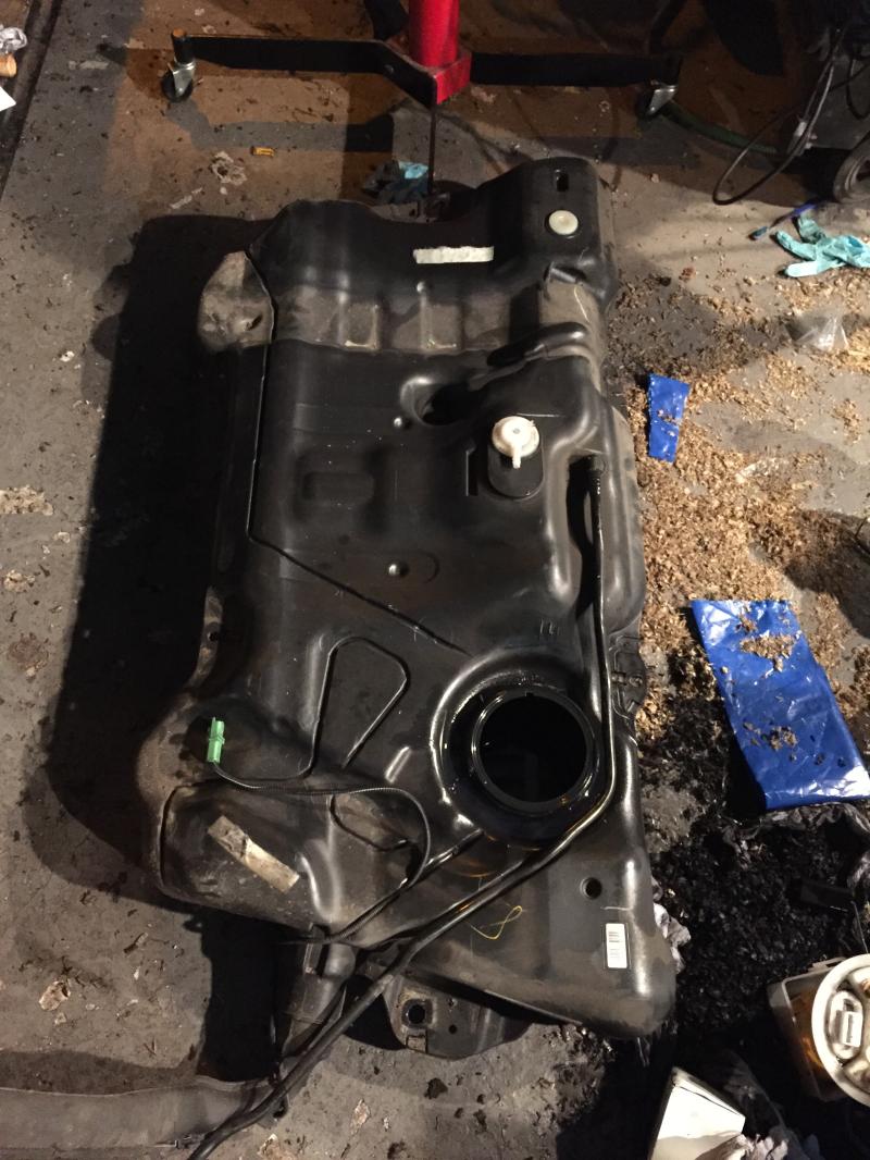

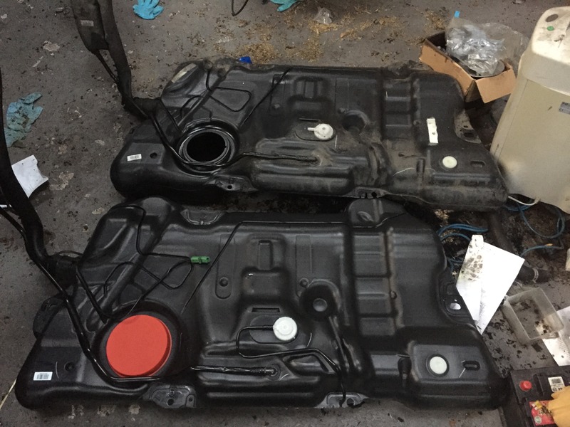

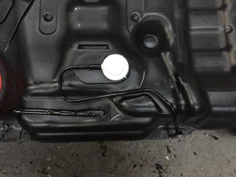

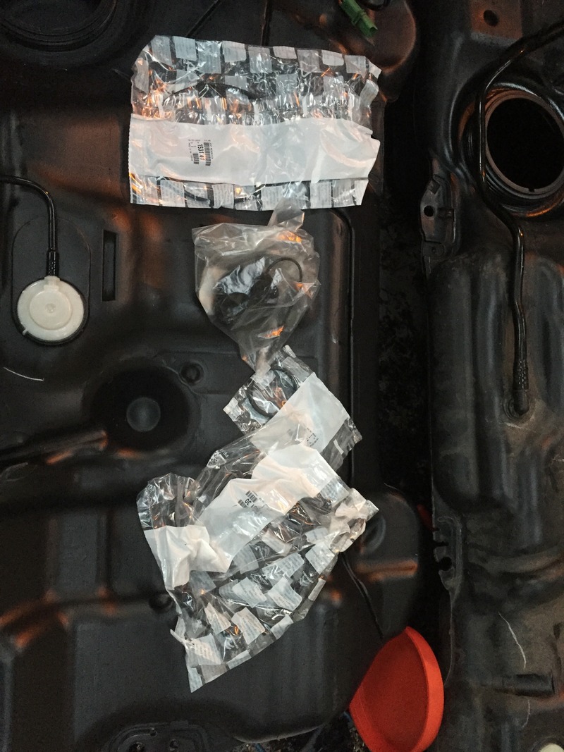

Well the new tank has landed today... The breather pipe has a slightly different arrangement to the old tank...
Old:
New:

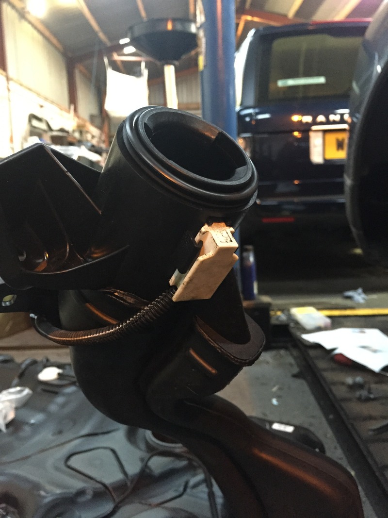

Here's where the spring we found lives...
The only thing that I needed to take off the old tank was the magnetic sensor for the fuel filler cap...
The o-ring around the sender unit and the hog ring that hold it in were replaced, the string on the fuel filler cap was broken so that was replaced and I'd ordered a new o-ring for the top of the filler neck that seals onto the cap but the new tank came with one of them already fitted.
Unfortunately I'd forgotten that there were a couple of small clips that had broken when the tank was removed, the captive nuts that hold the arch liner in were corroded so I'm going to order some new ones tomorrow, hopefully the dealer has them in stock!
Anyway, we're getting there!

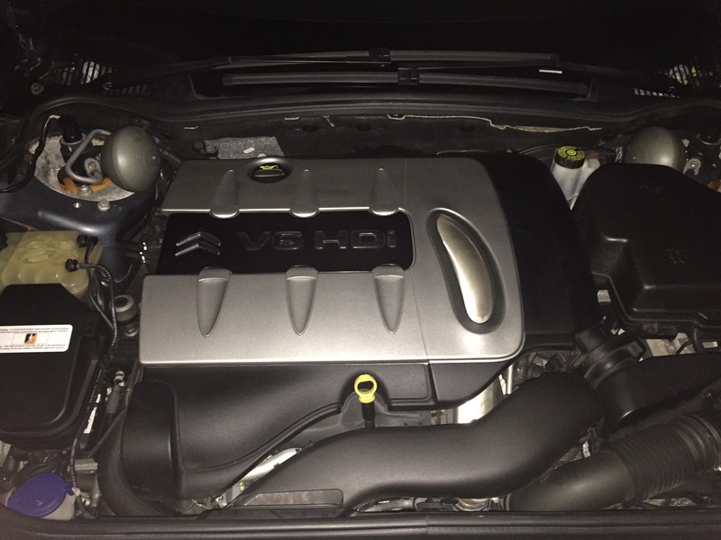

A few weeks ago I emailed the chap I sold my 2.7 Exclusive to 4.5 years ago to see if he had any intentions of changing it. I mentioned that I had a 2.2 but was looking for another 2.7. Donnie lives in Stornaway and only does about 3k miles a year so the better economy and cheaper tax were appealing to him so we negotiated a deal which ended up with me getting my old 2.7 back!
Today, Cheryl and I had a lovely run to Inverness in the 2.2 HDi today to meet Donnie. Cheryl and I drove home in the 2.7 and Donnie drove off in the 2.2

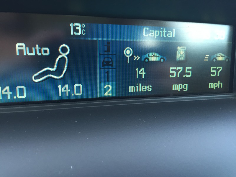

Leaving Glasgow today we were sat doing 55 for about 14 miles in 6th gear due to the traffic being a bit slow moving. At a steady 55mph on the cruise control the 2.2 will do nearly 60mpg!!

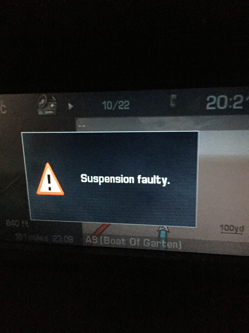

As you leave Inverness there's a steep hill to climb as you come onto the A9, in typical Citroen style the 2.7 decided to throw a wobbler!
I've had the Lexia on it and it didn't show any faults logged, I noticed later that it seemed to alarm as you hit an uneven part of the road or when on hills so I'm just wondering if it might be a bit low on LDS. Anyway, I'll get a proper look at that tomorrow and see what's what.
