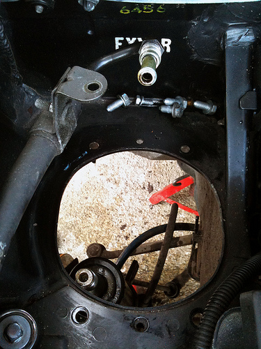

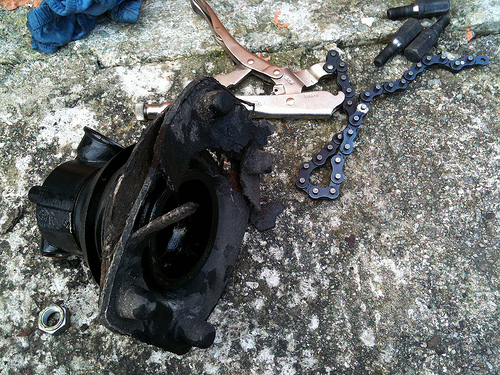

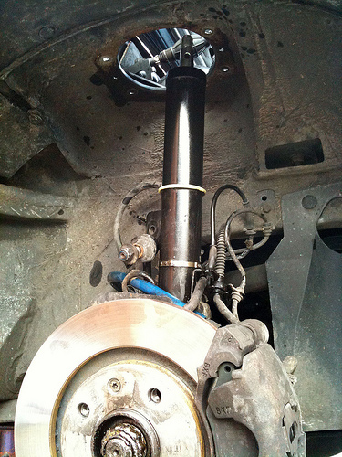

I got the top off now, it was sooo much easier than i thought it would be to get it all off, strut still attached to the bottom, but all other connections off
The metal was like rotten wood!
The following are just for reference more than anything:
So what is different on the VSX ones, the nut that holds the feed hose in place, or the one that holds the strut to the top?
If it wasn't for the unexpected cost I wouldn't be at all bothered, but budgeting for the unexpected these things throw us off course in life, dad has just had to replace BOTH front springs on his mondeo, and there i was boasting that mine doesn't have springs... it has rotten strut tops!

That one was bad Dei
The difference is in the feed pipe and union fitting. The top nuts are the same. Hydractive strut tops have 10mm pipe unions (thick pipes) whereas non hydractives have 3.5mm pipe unions (thin pipes).
