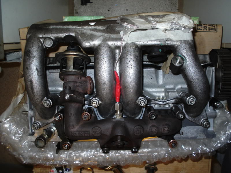

I can now give my findings about EGT's.KP wrote:Can a TD Really generate that much heat?? I know of the heat issues for petrols, and been there myself, but i always thought TD's ran much cooler on the EGT side of things?
I had already tweaked the LDA a bit for more on-boost power but not so much as to increase soot levels (as more fuel meant more boost) and found peak EGT's peaked at 500c as this video shows.
Comforted by this I upped the fuelling more and increased boost to keep the smoke down. At full throttle and high rpm, I can see a hazy trail behind me in following headlights but nothing I'd consider offensive. However, off-boost smoke is another story
Without access to the max fuel screw, I have increased fuelling as much as possible via the LDA settings and matching boost pressure. This gives a peak EGT of about 650c up to 70mph.

Where are you measuring EGT Mike? Is 650C safe long-term for the turbo?
What is the standard EGT value? I ask as diesel turbos don't generally like running too hot which is why a diesel turbo on a petrol engine is not a good idea and why many petrol turbos (2.0 TCT included) are watercooled.

CitroJim wrote:Where are you measuring EGT Mike? Is 650C safe long-term for the turbo?
Interesting stuff this...
At idle and low throttle, the temps stay a nice ???c-250c. At moderate acceleration, maybe 400c and flat out (on a stock tune) saw no more than 500c.
As for what's safe, I haven't got it straight from the horses mouth but estimates vary from 750c to 900c sustained... I'll let you know when I find it.
Yes, petrol engines get far hotter - another reason I love diesel
