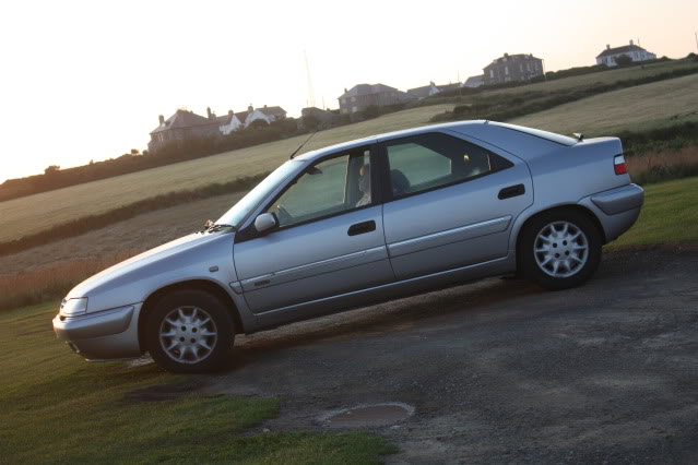

It handled well even with the heavy load and was a pleasure to drive so i am very pleased with the Xantia performance.. Below are a few photos of the car in various locations around Cornwall..

That's great MPG! The Activa will only do about half that, although I'm sure I could get more on a run if I kept it below 90! Our last trip away (from Rochdale to Lincoln) returned 27MPG. My best is 29MPG on a trip to the Lake District. 390 miles on one tank is really pushing it in an Activa!
Your Xantia looks to be riding great. The height looks just right on all the pics. Lovely looking car too!
