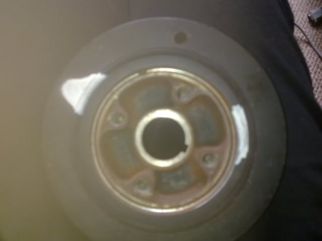

The new pulley should be arriving on thursday at a rather steep £122 from the dealer im also going to fit a new auxillary belt of the correct length, as the current one is a bit tight.

Well the pulley arrived and has been fitted today,
Think ill be keeping an eye on it though as i couldnt get the bolt that tight due to the engine turning over.
Did use plenty of threadlock though.
I also fitted a belt of the correct length, someone forced on a shorter one at some point.

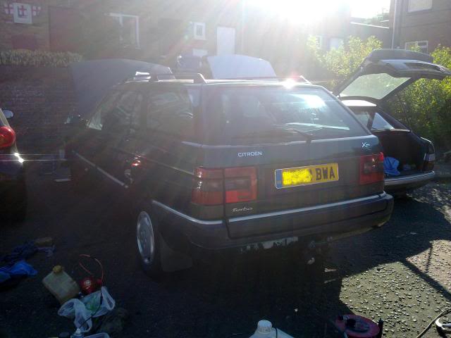

Yesterday I had my brother and Dad over to crack on with the estate i got recently for my parents to use.
It turns out its not as much as of a basket case as I had thought.
It has full and very comprehensive service history untill 2007 written down.
I managed to fix a very very very simple major LHM leak, (i Like leaks like these!)

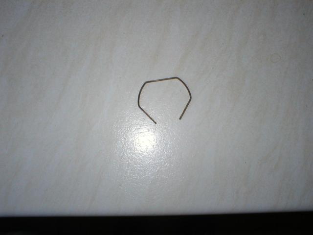

Someone had fitted new rear spheres (dated late 2009 and I pressure tested them to about 40bar
and they had left the old sphere seal in situ, so double seal = big LHM leak!- not any more !

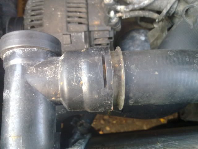

and the suspected headgsket failure turned out to be rather more simple crap connection.
Hopefully some sandpaper and a new seal may fix this one!

here is a hazy picture
Seriously though becasue of the water leaked the engine bay looks like its been drive through the sea! all for a cheap seal!
The other annoyance is that the owner lost the keys, so im trying to source a lock set as he dismantled the ignition and its rather fiddly to start!
Thats rather a long post for me!, an update will come tomorow when i free the intercooler and go get some new rubber for the estate.

Cheers Jim, I have Pmd you as im not sure if the bit i have is a clip or not, it looks very simple for a clip - just a piece of strong wire really.

Hi Dave,
Here's a piccy of the clip. It's made of springy wire and the shape is critical..
