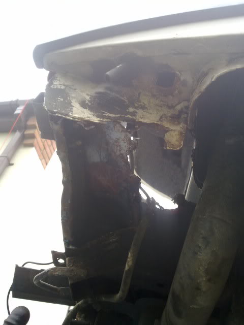

Ive been welding the cx for the past few days, and have learnt that if you see fibreglass then leave it alone....
And a view from underneath
None the less it is getting closer to being MOT'd and my sheet of metal is getting smaller and smaller!

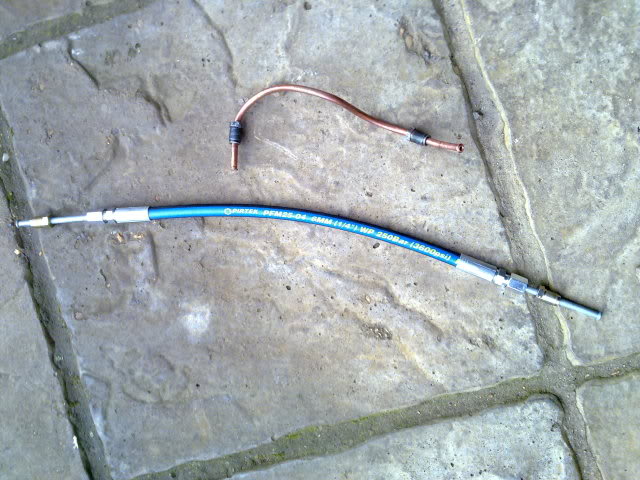

Hopefully it will be at the cxm!
I talked to martin from pleiades after looking at the pipe, and it has failed the same way as the last three.
So it looks as if some bush has failed causing the rack to move and therefore causing the pipes to break.
So as a temporary fix untill the car comes off the road for lots of work, i got this made from pirtek.
Hope it works! Ill fit it in the morning!
