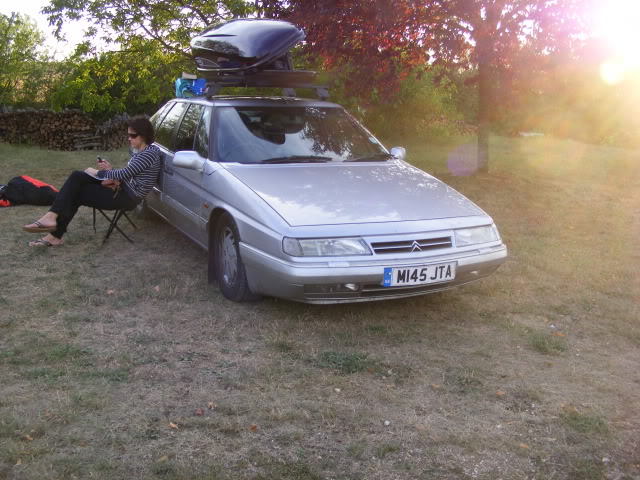

Well i arrived back in england on tuesday after a three week stint in france and spain.
I finished work fitting the turbo approximatly 8 hours before we were due to set off. To say I was worried about not finishing it in time would be a serious underexaduration...
Sadly the damn think still screams despit refurbishing, but pulls well so i suspect a hole in the intercooler.
Then i had to load the car with 5 people, a roof box plus as much fuel as it could carry...which including the tank we reckon to be between 250-280 litres! Not bad for something that isnt a lorry!
We then spent a week in southern france, followed by a week in spain and a week back in france.
Most of us were genuinly surprised that bar needing 2 filter changes and more LHM due to several leaks the xm made it no problem!
3000 miles in total
And in diesel it cost just one tanks worth after we ran out of veg...
So all in all pretty pleased with the Xms performance!
Will hopefully be attending the CXM on sunday!
