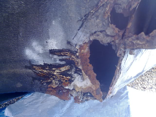

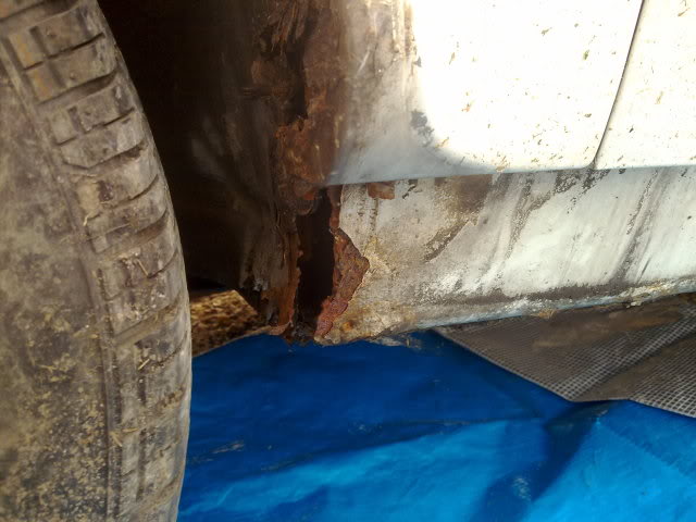

Well work has commenced on the 2.5 diesel Cx!
I was hoping to get the welding done and MOT it for the Cx rally, however i seriously doubt that will happen having looked at the rust!
Up in the air!
Starting point...
Thats perhaps one of the less rusty parts, i think this car has lived in the sea at some point, although oddly the bodywork is in very good nick!
More pictures later, me and Mr Angry Grinder are going to have a word with the car...
Up in the air!
Starting point...

- Posts: 52791
- x 7242
Dave,
That's minor rust
Any owner of a Brit classic would have that dealt with before breakfast!!!

Well I only managed to put a couple of plates in, with some poor welding! First time and all that, with no sandblaster i reckon its probably a 5 year fix at most.
More work in a couple of weeks, i will definately be filling up the sills with used engine oil when its done.

A five year fix Dave? Surely you can do it sooner than that
Have a look at some of the classic magazines for a bit of inspiration. They seem to be able to rescue metal that has taken on the appearance of lace!
