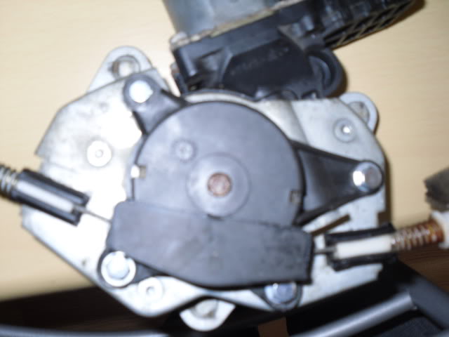

An update...
Sadly the brakes are still shockingly bad and i am shamed that im still having to use my girlfriends daihatsu cuore if i think i might encounter traffic!
I took the window regulator to pieces and put it back together, bought a new switch and the window now works
Well that sounds simple, it wasnt! Had to repair a plastic clip i broke which was a nightmare!
Heres pics of the regulator, the 4 bolts in the pic replaced the rivets i drilled out.
Just need to work out how to sort the door trim out to stop the water now!

Well another update, the window i thought id fixed isnt
The plastic clip i thought i photographed as repaired jut snaps everytime the window reaches the bottom.
It really does look and drive like a dodgy shed atm, got sellotape on to try and stop too much water getting in the door! Cant wind the window down due to the broken clip so have to open the door for barrier machines
The sunroof leaked aload of water on me yesterday so i tried to do it up and pressed the wrong button, then it wouldt do up again
. had to take the switch off and clean contacts again, managed to get it done up in the end though.
