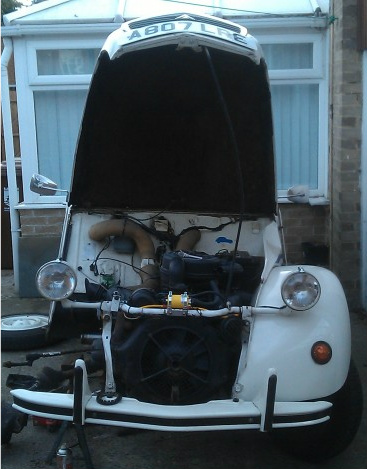

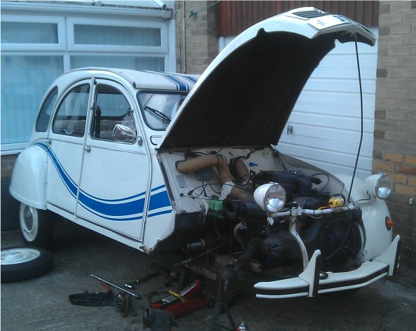

After that I helped my dad removed the front suspension arms on the 2cv. The King pins are slightly worn and so will be replaced, probably have the arms sand blasted and painted and new front wheel bearings at the same time. A very easy job to remove the front arms, took hardly any time at all. The front wings are held on by 4 bolts and remove in seconds, excellently usefriendly.
