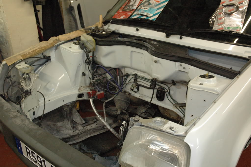

Started the stripdown tonight, Hour & half & only the shafts left to remove then out it comes. Forgot how much space there is with slampanel off!
