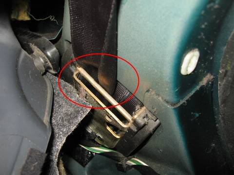

I was faced with a MoT fail as my estate rear seatbelts were retracting too slowly a few years back. I tried dismantling and lubricating the belt spindles; a terrible job (don't do it) and it made no difference. In the end I trimmed and reshaped the slot in the c-pillar trim they disappear into. This made a lot of difference and got my MoT pass. Even now they still retract swiftly.
Dave
Dave

Hi Dave, I have attached this picture in another thread earlier. Rear seat belt stopped retraction and the reason is seen below. After fixing it is functioning now but it is slow.
Is this seat belt slot same as in yours. What kind of modifications did you make there?

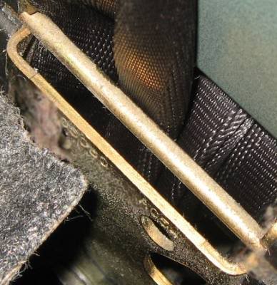

I have been trying to figure out a modification for the seat belt but unfortunately I didn't come up with a solution yet. Here is a close up from the same original picture. The smooth curved surface of that metal makes me think that the belt should go through that gap there. Am I right OR (right) ... ?
Any ideas?
