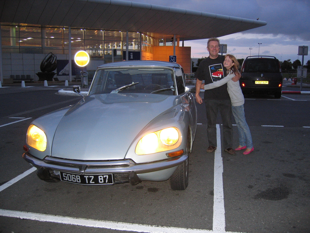

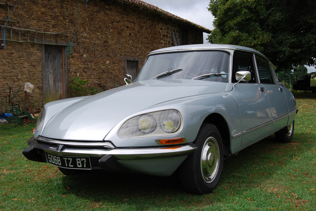

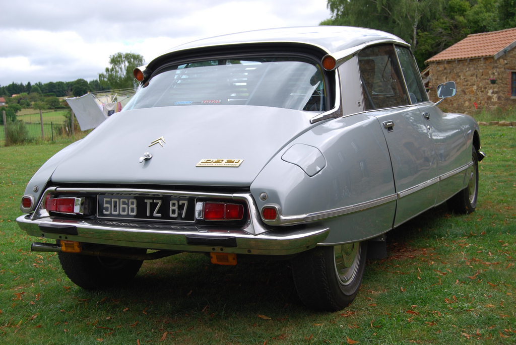

Having just opened a Flickr account I though I'd add a few photo's from my collection, the first one is as the Goddess was being driven out from her French barn for the last time;
The following pictures were taken in the garden by her previous owner
On the journey home it would have been silly to miss out on the obvious photo opportunity, notice the missing piece of trim? Now sorted BTW.
This last one is from the journey home at the Eurotunnel terminal in France with my daughter Danielle.

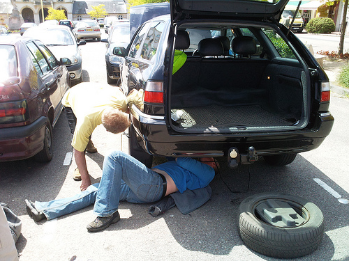

So last Thrusday morning four of us set off in the car and caught the Newhaven to Dieppe ferry and had a pleasant crossing on a calm sea with the sun shining. Having cleared Dieppe I set off to where we were staying (Honfleur) but just ten miles into France I noticed the "Stop" and brake lights were flashing at me which in 14 years of driving Citroën's was a new and rather worrying experience for me. As the car still stopped, steered and accelerated normally I limped the car a couple of miles to a town we could see in the distance then stopped in the main square car park to carry out an investigation. As a stopped I put the suspension onto its highest setting and lifted the bonnet only to see the float on the hydraulic reservoir drop down below the maximum level almost immediately so I quickly switched the engine off and peered under the car to see LHM fluid dripping into an ever increasing puddle under the nearside rear of the car.
Needless to say at this point thinking that a high pressure hydraulic pipe had burst I was very concerned that our journey was about to come to an abrupt end. However I'd taken quiet a collection of tools with me so I jacked the car up to take a look under the car but could only see a stream of drips running down from above the rear subframe, taking the nearside wheel off didn't really help locate the source but a glimmer of hope came when one of my friends had a poke above the subframe and noticed that he could cause the flow to be interrupted if he moved a plastic return pipe. Long story short, what had happened is that the return pipe had slipped off of its rubber push fit joint so simply poking it back together stopped the leak. Better still is that literally just around the corner from where we had stopped was a Renault garage which had three litres of spare LHM to refill the tank and get us on our way again.
The big question running through my mind was why did the pipe slip off, was it due to excess pressure due to an internal leak? Having now completed over 800 miles over the past week (since the repair) and that all is still well I'm coming to the conclusion that when the reason for the failure may have been down to previous work on the car several years ago when the rear Hydractive valve and height corrector were replaced which may have disturbed the pipe joint leaving a ticking time bomb. Whenever the car is left it maintains its normal ride height unless a door is opened which opens the Hydractive valves so all appears normal at this stage so I'm employing a "watch and wait" policy whilst carrying a few litres of spare LHM just in case it re-occurs.
