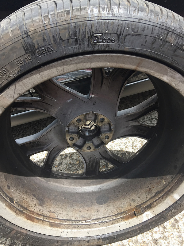

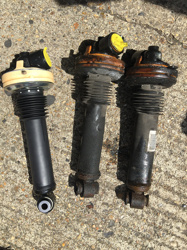

I was quite busy last weekend changing both front struts on my C5, not a particularly difficult job but you do need to remove the upper mount complete with the wishbones in order to manoeuvre the strut out, something I hadn't bargained on was that just undoing the top nut on the drop links didn't allow them to slide out due to the acute angle being beyond the range the ball joint can cope with due to the length of the upper stud which locates the bottom of the strut, needless to say one of the lower nuts wouldn't play ball and had to be cut off requiring me to purchase a replacement drop link.
Once the struts were sorted I flushed through the brake fluid on the C5, C3 and the BMW after discovering that cars fitted with ESP require a different brake fluid from standard in that the fluid is thinner to allow the ESP to operate faster.
The mess the O/S strut left on the inside of the wheel/tyre.

I'm shocked at how leaky the old ones are Richard

They were only leaking from the shaft seals, the mess at the top of the strut is fluid that leaked out during removal, the O/S one was a fair bit worse that the N/S which in fairness was only seeping. Bizarrely sometimes the O/S strut would leave a small pool of fluid when parked then sometimes nothing at all with nothing I could distinguish as to why the difference, no change in what the car had been doing etc.CitroJim wrote:I'm shocked at how leaky the old ones are Richard![]()
One strange thing about the struts is that the O/S one has a bleed nipple at the top whereas the N/S one doesn't.
Once the mounting plate the strut top bolts onto is released you can manoeuvre the strut out without removing the driveshaft, I did undo the driveshaft nut and pushed the shaft in through the hub so that I didn't pull the shaft out from the diff.CitroJim wrote:I trust the wishbones on the C5 are easier than on a 407... Did one the other week and they need to have the driveshafts removed first, at least on the 4HP20 equipped ones.. It was a right 'mare![]()
It does seem strange and TBH not as easy to bleed as LHM brakes but there you go, that's "progress" AKA giving the customer what they want, new car buyers don't appreciate traditional Citroen brakes and after spending out £500 I'll admit I'm starting to wonder about the wisdom of the hydraulic suspension with seven sphere's @ around £100 each.CitroJim wrote:Brake fluid in a C5? I still see that as wrong, very wrong
