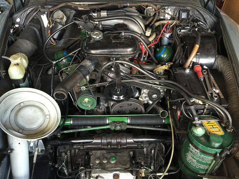

Great idea Malcolm, we use an induction hob at home and it works a treat so whilst I quite fancy getting a nut induction heater the £1,000 price tag is putting me off at present.
Update on the DS, after removing the radiator I managed to grind away enough material from the water pump to eventually remove it, fitting the replacement was straightforward enough but I noticed that the tin plate used to time the ignition (it's attached to the water pump studs) was rather bent so possibly giving inaccurate reading's so whilst I had the opportunity I checked the timing by removing a spark plug and popping a long screwdriver onto the piston then rotating the engine to find TDC. I discovered that the plate was out by about 2° so I bent the plate into correct alignment then put the car back together so to speak, having done so and checked for water leaks I adjusted the ignition timing accordingly and noticed that despite the adjustment only being 2° the engine now runs far smoother than you would expect from such a small adjustment. However having since thought about it, unlike a modern fuel injected car that has a TDC sensor fitted to read the engine position directly off the flywheel, on the DS EFi the fuel injection get it's signal to 'fire' the injectors directly from the distributor so at the same time as you adjust the ignition timing on this car you also adjust the timing of when fuel is injected possibly making accurate ignition timing far more critical on a car using a similar system. Time will tell if I'm simply suffering from the 'placebo effect', anyway all is now well with the DS for the time being.
The original water pump showing the area around the seized stud.
The front end of the DS with the radiator and ducting removed showing that this car is a bit like Triggers broom with the number of new parts now fitted to it, water pump, lower water pipe, steering rack, sphere's, hydraulic pump, clutch re-engagment tool, 123 ignition distributor, coil, manifold pressure sensor, alternator, battery and brake pads, I don't even want to think about the cost of that lot!
