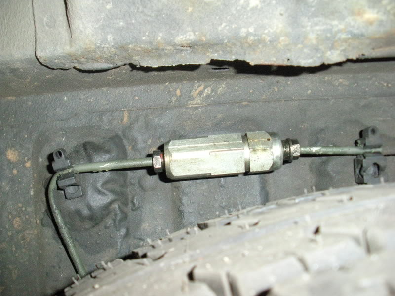

Here's a pic of it
Unread post by bv2991 »
Okay, I don't quite know what it does, but my guess is it stops the rear brake from locking up. There's a built-in pinhole on its body. Right now, fluid oozes from this hole when pedal is depressed. Sorta saying that something seized-up inside.
Here's a close-up pic of it. Can you see the dot on the body? That's the pinhole.

that's just a union and you can buy a new one ( I see the thread on the right hand side is well out ) compared to the left side this could be your problem as the leak could be coming from the thread rather than the union?, the reason they put a union there is mostly because its not possible to fit an all in one line due to things being in its way like going through the chassis
