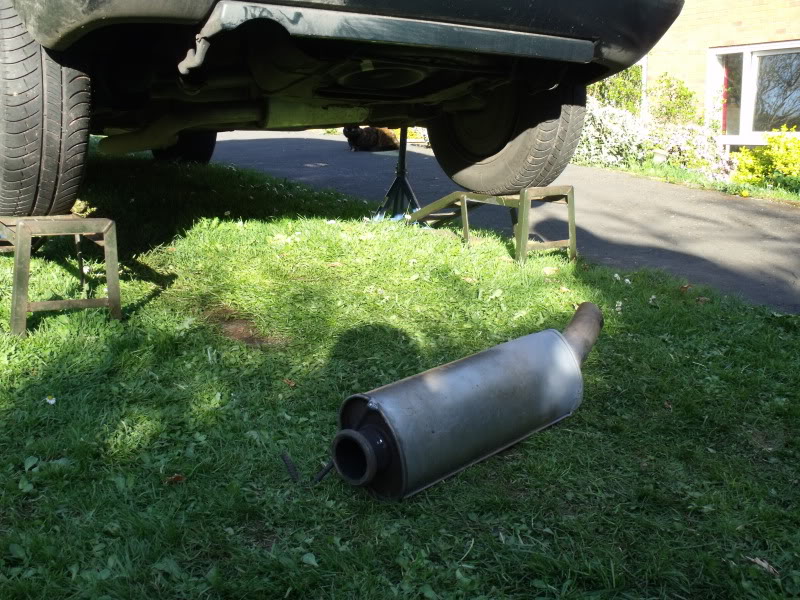

Todays job was the exhaust backbox. I spent lunchtime ringing around to try and source one for a sensible price but the cheapest I could find was £70
Que a trip around the local trading estate after work looking for suitable scrap exhaust systems. We came up trumps with two exhausts in very good condition with the correct diameter piping, one of which will be used for the XM and the other for some guy dad knows who wants one for his tractor.
Work began on the XM backbox this evening, pipes shortened then flanges matched up followed by a reduction in the length of the silencer to fit, thats tacked back together now and will be welded proper tomorrow. Final things to do on that are the mounting points and smoothing off the tail pipe.

In other XM news, the backbox is coming along. We've welded the end plate back on properly and smoothed the join off with the grinder, you would hardly know it had been shortened. After putting it on for testing we found that that third silencer does infact make a difference to the sound and there was no blowing on the joins
We've now fitted two spare rubbers, manufactured two suitably fitting hangers and tack welded both on. The first one is perfect but we do need to alter the one nearest the tail pipe.

We finished off the exhaust this evening and fitted it. Quite pleased with that job, heres a picture of the home made silencer.

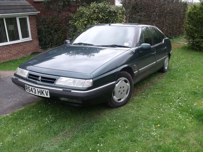

Here's one of the XM in all her glory, I can't help but grin sometimes when I think that I've actually got a 2.1 TD XM with a manual box and a decent trim level
