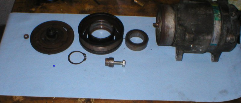

Popped over to Jim's this evening with a replacement a/c compressor for Cassy that I'd picked up at a reasonable price from ebay.
The bearing on it was showing signs of old age but as I had a spare that we were unable to fit to Cassy's compressor (due to the threads on the pulley being too rusty to work with), I thought it might be easier to do it with one, sans car, on the bench.
Turns out I was right, and in no time Jim had the pulley off and I was making a mess cleaning the parts up ready for the new bearing.
Jim had some dinner and then using the remains of a Xantia wheel bearing, pressed the new bearing on and the pulley back on the compressor.
So the next job is to get a 32mm spanner, find out if anyone can suck out the gas, remove the old compressor and fit the new one to then be re-gassed.
Simples

Xac wrote: and then using the remains of a Xantia wheel bearing, pressed the new bearing on and the pulley back on the compressor.
It's amazing what an old Xantia wheel bearing can do. they’re magical things 8-)
I perhaps ought to state I was using the remains of the Xantia wheel bearings as mandrels in the hydraulic press...
Good to see you this afternoon/evening Xac! :-D
This is a picture of the a/c compressor clutch disassembled and the special puller I knocked up on the lathe ages ago..
