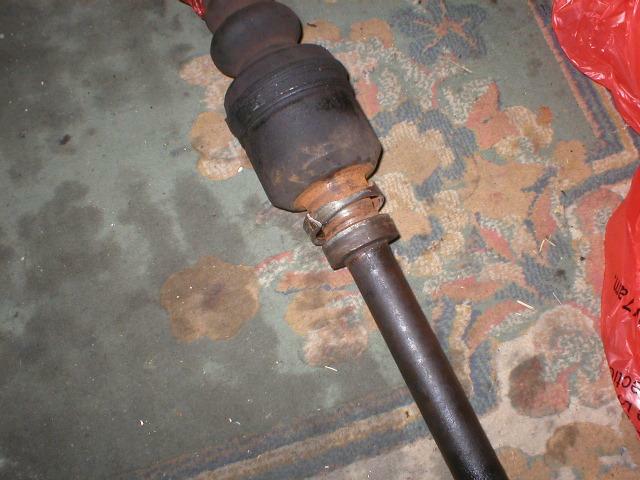

The same cannot be said for the LX Jim and I spent the day working towards getting the engine out of.
Firstly I could only get the off side hub nut free, but Jim turned up and with is strong breaker bar and all my 20stone on it, the nut finally came free. Stupid thing is, as soon as they're cracked, you can just spin the nuts off!
Jim set about removing the drive shafts, and discovered that the intermediate bearing was pretty much non-existant!
With plenty of percywotsit he managed to free the shafts but there was nothing left of the bearing.

That was a fun afternoon Xac, despite the fight the car put up. We struggled for an hour to undo a lower swivel nut because of a damaged thread on it and then struggled hard with the RH driveshaft due to this collapsed intermediate bearing:
It had broken up and gouged the housing, making it nearly impossible to release the hockey-sticks due to gouged metal shrouding them!
This bearing failure did not apparently show up when driving :roll: :lol:
