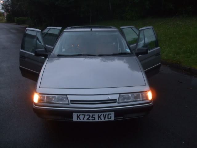

Your XM is looking great Vince, I love that door open display. Wish mine had one, the display on mine is useless, it only tells me things I would rather it kept to itself. Mainly that of the ABS since it has an intermittent problem.
I bet your loving driving about in the XM, they are a totally different thing to Xantias.
Its colour does suit the shape well too, thats not the normal grey though is it? Its quite a light, almost greeny, grey. Looks very tidy

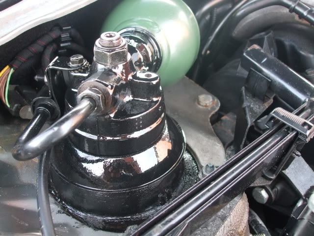

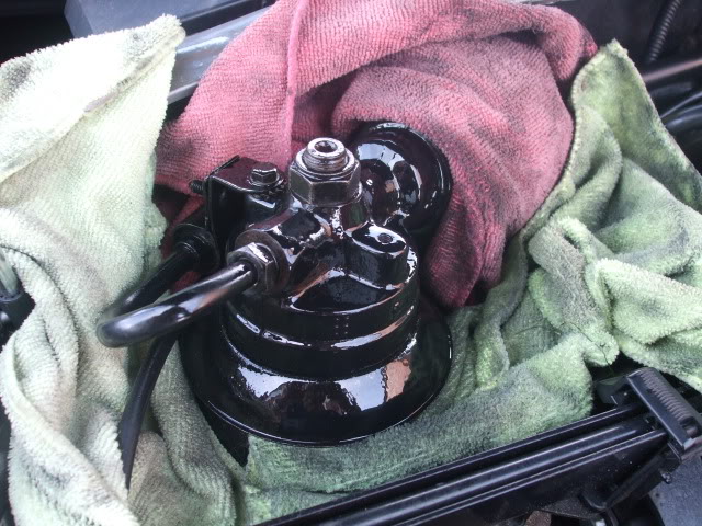

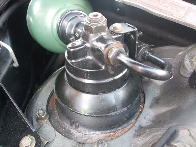

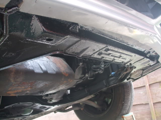

Today saw work start on the rolling resto clean up project
Naturally the underside of the xm is going to take priority to stave off corrosion, but also the top half is easy for anyone to do....not many people do the underside too
Front subframe as it greeted me earlier on
With the rust brushed off a nice new coat of smooth black hammerite now covers it which should keep it corrosion free for a while at least
plus it loosk so much better

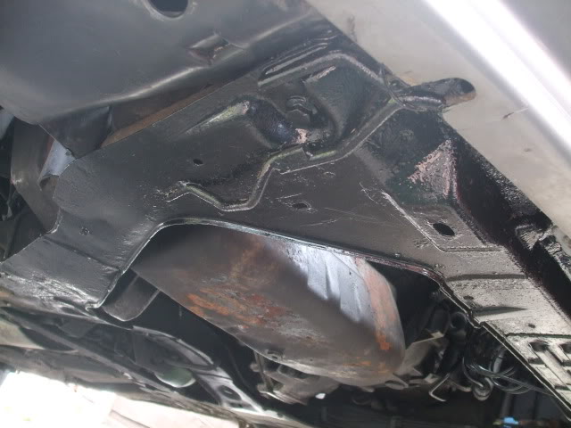

Next up were the top mounts. These are being painted to help keep them dry and water proofed. The undersides will be sealed once the arches are done
There is no rush on these as luckily they are like new almost
That was the main job for today....i also cleaned and waxed the passenger side door shuts and door bottoms and edges. They now look like new again

An already good base of a car to start with this xm is gonna be one F of a clean stunning car!! I hope you make it to Cxm september 8th vince.....
that subframe is stunning.. they do rot.. my sed one isn't particually brilliant and could do with this treatment...

Thats a very good idea, did you spray the tops or brush paint them?

Hi Chris,
I brushed the flat section with an artists brush and smooth hammerite, then sprayed the top section with hammerite satin black...keeps them looking fresh and also water tight. Underneath ill tetrosyl them after cleaning all the crud off. clean surface then locked in with underseal. Just need to keep them clean then

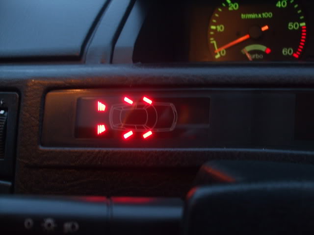

Anyway...back to the quirks of the xm....and some poorish quality pictures of the "northern lights" aka the xm at dusk

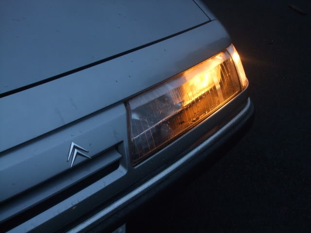

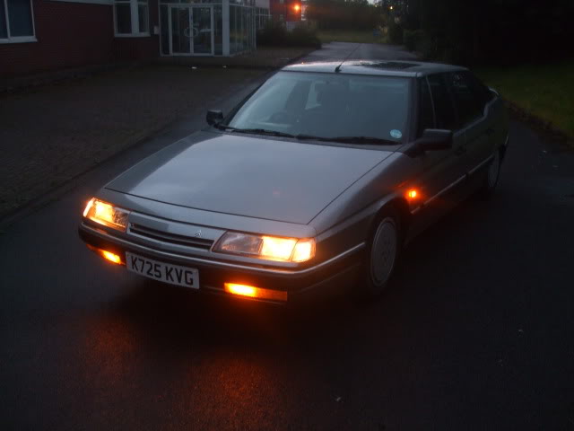

Its looking good, I'm liking the dash pictures
How have you got your lights to look so yellow/orange?
The Xantia is tiny when stepping out of an XM, you should try going from an XM estate to a Xantia hatch, its like going from a HGV to a supermini!

Lol,
The lights just come out that way Chris...they are on sidelight mode not dip beam. Somehow photos always show them up brighter.
Ive just messaged Andmcit on the xm forum....i cant believe he is going to be weighing in about 3 of these series 1 cars.....
I know he has no choice but im going to need so much stuff off them as i go through this project, that it breaks my heart.
Ive asked for his postcode to contemplate a trip down on a parts raid.....seriously considering it too
