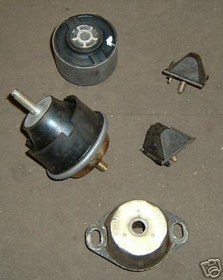

The bush that has gone is one of the smaller type as seen in this picture, which appear to bolt on, although on my mount it looks like its moulded onto the top part of the bracket.

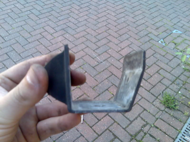

And here's the offending part, which according to the servicecitroen site, is available as a seperate part, or it has its own part number at least, so lets hope they have one in stock!

Went to the dealer ship today, part not in stock will be there Tuesday morning though, £21 quid inclusive. Should make a world of difference when fixed as its been going for a while. My temp cure of telephone wire wrapped viciously around the offending part seems to stop most of the wobble, got alot of miles to do for work on Monday so had to do something to stop the excess rock.
