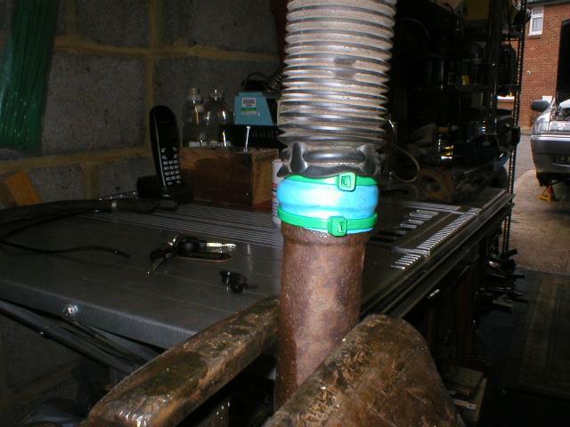

Two that were is the MK1 ram repair attempt. It may not work but the MK2 version awaits in the wings...
This is a quick glimpse of the MK1 attempt...

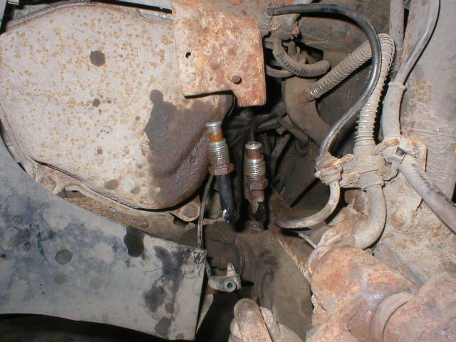

One big problem on the ram front was the issue of the seized flare nut on one of the hydraulic pipes to it. This nut had resisted many attempts to free it off and made ram removal a bit tricky. It was necessary to leave the pipe connected and with the other pipe disconnected, rotate the whole ram to undo it from the pipe. The flare nut had to be freed or the ram could never be replaced.
It was well tight and a weeks' dousing in Plus Gas did not help and nor did bigger and bigger spanners...
In the end I turned up the heat a bit and brought my propane torch to bear on the job. A good heat and I could feel just a bit of "give" in the nut. A bit more heating and a bit more "give" :D Success! You just can't beat a bit of heat to shift tight stuff.
As a result of heating, a small fire under the wing had to be extinguished. LHM burns nicely and the ends of the two hydraulic pipes looked like a couple of oil rig flare-off pipes :lol: :lol: :lol:
These are the two pipes in question, showing the flare nuts. Imagine flames leaping from their ends... :lol: :lol: :lol: :lol:
