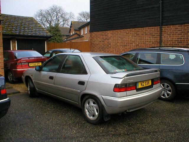

As much as i like a lot of the Xm and Xantia colours, silver is always my chosen colour for a daily driver. Its easy to look after, looks cleaner longer and hides minor scratches. Unlike black, i never want another black car. Saying that id like a red car next.
Actually i tried the Xm estate in a garage of a fairly modern house recently, with it about half an inch from the end wall it was still sticking out about half a metre! Id like to know why parking spaces are not getting any bigger, yet everytime a new car model is released its larger then the previous.

Silver has grown on me recently, the new car helps, but certain cars really do look the part in it, and its so easy to clean and maintain.
My old Activa looked stunning when freshly cleaned and polished but it soon got dusty and dirty without really going any where.

As I always say, some cars look great in silver whilst others just look bland. The Xantia is in the former camp...
