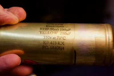

Jim - you might appreciate what a mate of mine has been working on. He's slowly bringing a huge old Army radio set back to life (you might even have heard of it :wink: ). He tried to reform the caps in it - they were last reformed in 1964 !! but they all failed, so next best option was to replace them with identical ones to keep it authentic.... but he couldn't get any. When you see the size of them, that's not surprising...

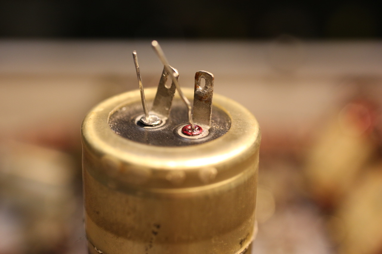

...so next best option was to cut them in half, hollow them out, and put new ones inside with the tails coming out the original tag rivet locations...
Hollow cap
Hollow cap
Cap tails
Cap tails
Finished cap
Finished cap
The cuts will be hidden by the clamps that holds the caps in place.

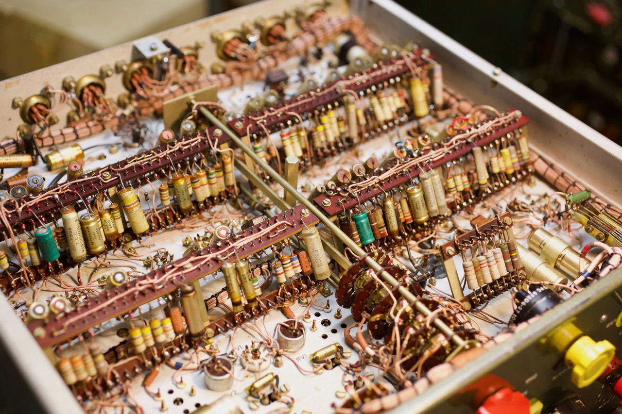

Next job is to check each and every component in this.... and then go on to all the other units in the radio kit #-o

bobins wrote: 10 Feb 2018, 21:46 Jim - you might appreciate what a mate of mine has been working on. He's slowly bringing a huge old Army radio set back to life (you might even have heard of it :wink: ). He tried to reform the caps in it - they were last reformed in 1964 !! but they all failed, so next best option was to replace them with identical ones to keep it authentic.... but he couldn't get any. When you see the size of them, that's not surprising...
Wonderful :D 8-) =D> That's right up my street! Keep me appraised of progress please ;)
Doing that with duff components to maintain looks is what we call 'restuffing' :) I've done it many times with big can electrolytic. Some even restuff wax capacitors and resistors!
Just make sure the small replacement electrolytics are up to the job with respect to their ripple current handling ability when used as the reservoir capacitor just after the HT rectifier... Many aren't and can fail spectacularly...
Make sure too that they are rated 105 degrees C as their cooling will be a bit compromised inside the old can...
