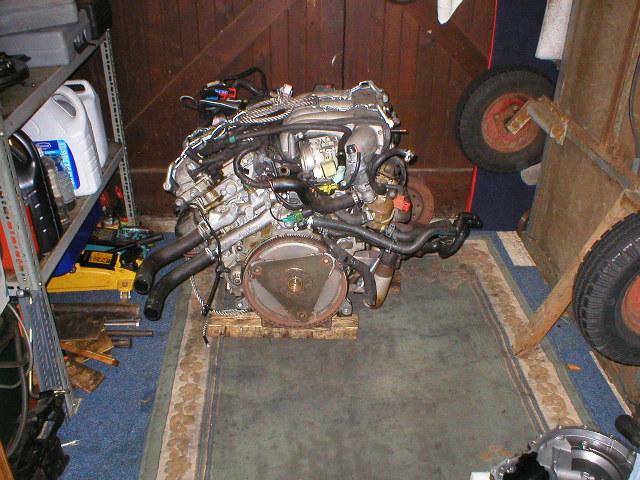

Toby arrived just as I'd got the exhaust manifold disconnected and within the hour we had the engine and gearbox sitting on the rug in the garage. No dramas at all except for when we were lowering the engine down onto its support blocks I managed to get a mouthful of coolant from the header tank hose :evil: Anti-freeze with bittering agents in it taste HORRIBLE and it has taken two cups of tea and a curry to take the taste away :lol: :lol:

Today has been an excellent day :D It was really great to have Toby's company and his very able assistance. We did, as the corner of the picture shows, get the gearbox stripped but we encountered a problem with the big slotted nut. My special tool is not quite up to the job and it came apart at the welds :twisted: A MKII version is in planning...
