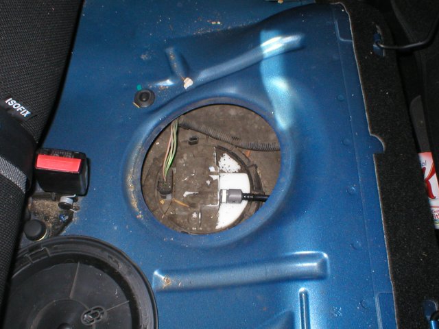

The pipe was easy to fit in the end... Here's the pump end seen through the access hatch under the back seat:

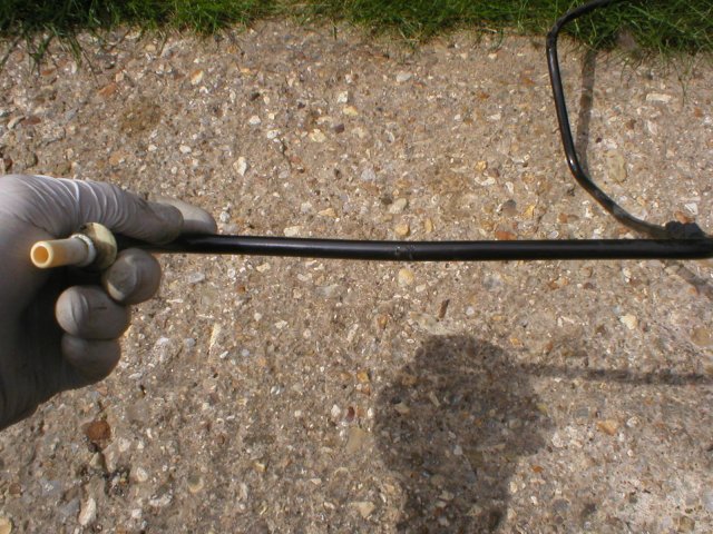

The pipe was quite easy to fiddle out once disconnected from the pump end...
Here's the damage on the old pipe...
Looks like rats have been nibbling it :? It may well have happened when Robyn was at Guide camp last week and the car was parked in grass for a few days..

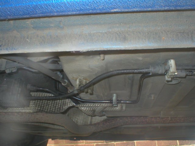

Here's the new pipe installed;

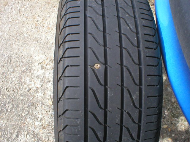

Whilst doing the job I spotted a screw in one of her rear tyres... That explains why it's been slowly loosing air recently...
The wheel is presently with our local tyre place having the puncture repaired...

At least the puncture is repairable given its location, another inch or so further out and that would be it.
Top of the tank / sender area looks a bit muddy. :D , Then again it is partly exposed I guess on this design.
Pleased to read you did the pipe without too much trauma, ServiceBox as mentioned elsewhere does not show a "remove / refit" for the pipework only the tank itself unfortunately.

Yes indeed Andy, the top of the tank is exposed a little and was covered in a sticky black dusty substance.. The white bits is where I cleaned it by wiping up spilt petrol after disconnecting the old pipe!

Puncture repaired FOC :D
