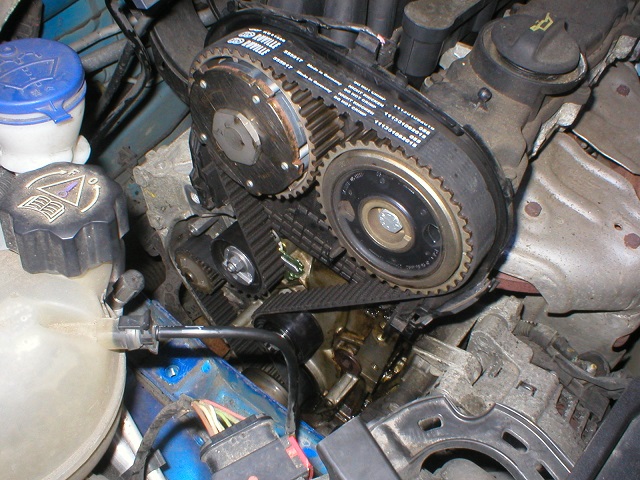

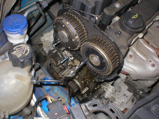

A few pictures from the 207 cambelt swap..
If anyone wants, I have a complete photo-sequence of the whole job...
First, old belt off, cams locked and tensioner and jockey removed...
You can see in the above the famous TU (and ET) signature had gasket oil weep!!!
Belt on and tensioner and jockey:
So easy, with the engine mount removed so much room too

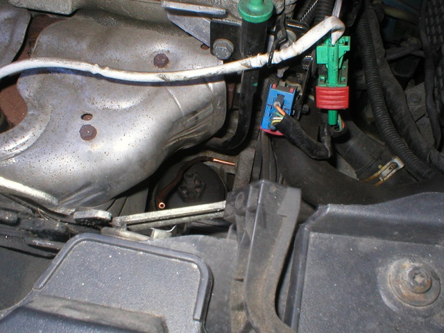

Also easy is finding the crank locking hole. It's no longer hidden!!!
Again, a bit of kunifer brake pipe does the job admirably!
