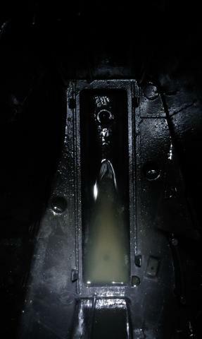

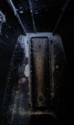

Back to heater matrixes, Xac took these wonderful photos of the bottoms of our respective heater boxes to show what a duff matrix leaves behind. No wonder they stink and make a wet mess of the carpet. Xac is to be heavily congratulated on getting these rare pictures as it is far from easy to get a camera a light in there at the same time, not to mention the access difficulties!
Firstly, this was my V6, all crystalline and dry as the matrix had been disconnected for a long while... Looks like it's full of sugar!
And this was Xac's Activa. Leaking well and steaming up the windscreen just before we extracted the old matrix...
