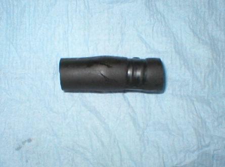

Did an oil and filter change on the V6 this morning as a nice, gentle introduction to a busy day. I took a good look at the pinion valve return hose and was pleased to see it nice and dry following the replacement of the perished pipe a few days ago.
This was the end of the old pipe where it slips over the end of the metal pipe. You can see the cracks that were weeping LHM.
