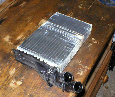

Today we replaced the heater matrix in my 2.1TD that had been leaking for getting on perhaps a year and was only held togeter by Forte Stop Leak. Replacing a matrix in a Xantia is a very major job and a full days work. Without Richard's help and deep knowledge of this task it would have taken considerably longer and with a risk of doing real harm.
The job went like clockwork and luckily, the matrix water connection, usually the difficult and risky part of the job, only put up a token fight. That was lucky as on the 2.1TD, access to the connector is very restricted. As it was we had to take the top half of the inlet manifold off to give greater access. Richard's trick of letting the engine get so hot the fans cut in and then immediately attacking the connector works!!!
The old matrix was in a shocking state as the pictire below shows. The Forte Stop Leak had done it's job well as it was as dry as a bone but smelly still because of the crusty crud both on it and the large quantity of crud that had collected in the bottom of the heater box. We broke it up with a screwdriver, hoovered it out and then gave the heater box a good wash out with a sponge.
The heater now gives lots of lovely hot air but still smells a bit but now it is a good smell, a slightly oily smell that all new maxrixes make when first used. A rare case of an oily smell being a very good smell

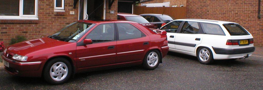

Here is a picture of both the cars, freshly cleaned.
Look very carefully and you can just see Gareth's 1.9TD hiding behind my estate as it patiently awaits it's pump to come back after some TLC. We'll say nothing more about next door's car. It's not French and it's not a Citroen...
EDIT: The Estate looks low at the back as I'd been in and out of it a few times whilst cleaning it without starting it up and thus causing it to sink somewhat...
