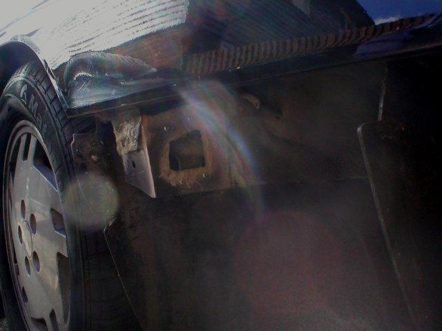

This was the extent of the damage:
We, as it's beyond me now to do, made a repair piece with some aluminium sheet and some pop rivets. That was used with a good coating of cavity wax to make a repair plate..
Not a good picture as it's been a lovely day and the sun got in the camera...
It's strong and does the job a treat...
After another small repair on one of the bumper lower mounts We reassembled and was delighted to see the new bracket is doing the job a treat...

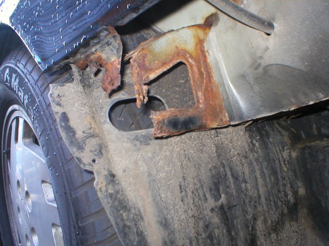

I see I have a similar problem on one side of the rear bumper but it's the opposite problem; the plate on the bumper itself holding the captive nut has rusted badly. The underlying body being fine. Another job to add to the list...

I think the mount on the rear bumper has not been helped by the impact it had at the time of the wing dent.
