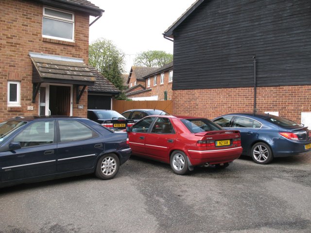

I gave Mme. Activa a good scrub today using just a bucket and chamois due to the hosepipe ban. It's a long time since I've washed a car like that but despite taking a while longer the result was superb.
Here she is along with a bit of shiny V6 and a very mucky looking Rattiva... She's only had her usual Saturday health check and she's good
She really wants for very little really... Good old Rattiva. I love her to bits despite her dog-eared bits. She's like a comfy old pair of slippers
Sorry a Poxhall crept into the picture

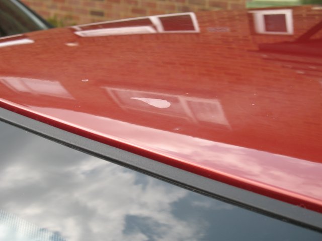

Mme Activa has problems though. Her roof lacquer is de-laminating and there’s areas of white all across the roof. I'm not sure how best to go about having it sorted...
Here's the worst area of de-lamination...
It's like a big tear-drop
Some smaller areas can also be seen along with a bit of what looks like white bloom. I know that's the sart of de-laminating now...
Still, apart from that, she's not bad...

Get that lacquer seen to soon Jim. And you will hopefully get away with only having to re-lacquer and not re-painting.
