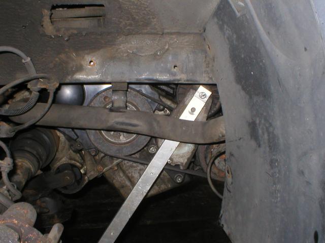

After Old V6 was sorted I resumed work on Juliet. I'm delighted to say she's now all done bar needing filling with coolant, having a new battery and the CV boot. Xac brought me a boot today but sadly it was the for the wrong side. The driveshaft diameters are very different on each side.
Juliet's cambelt tensioner was well past its sell-by date. It was both very sloppy and rumbly... We now know why the cambelt was so floppy :twisted:
I nearly had a disaster though. On disassembly we found the auxiliary belt tensioner was a bit stiff and this made the belt very hard to remove. For reassembly I 'worked' it a bit with a small breaker bar in the square hole and it came good :D I then went to do it one more time to fit the belt and crunch! Ping! a bit of the casting around the square hole broke off and flew across the driveway :evil: This sort of made the square unavailable and basically it seemed impossible now to set the tensioner so the belt could be fitted. Those tensioners have a hell of a spring to them and it seemed that whilst the tensioner itself was perfectly good, there was no way of setting it so as the belt could be fitted.
I tried a few ideas, all of which failed :( And then hit upon an idea after noticing the threaded hole where the jockey wheel screws in was about 3mm deep. Also, by the broken square was a smaller hole for pinning the tensioner in its released position. I made up a pin bar that would place a pin in each of these holes and I'm delighted to say it worked a treat :D :D In fact a heck of a lot better than using a bar in the original square hole. So, a potential showstopper turned out to be an opportunity to find a much better way of doing the job...
Here's a shot of the pin bar in place on the tensioner. It really makes light work of the job :D

I came across the same problem as your tensioner in a 2.0 16V XM, Fortunately on the Xm there is a small bar linking the subframe to the shell, so I could lever a crowbar against it to push the tensioner back, but I like your solution, I'll store that in the memory bank.
