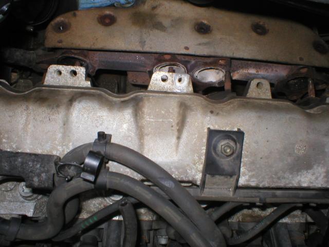

Done it :D :D :D :D
Here's the manifold sitting about an inch and a bit from the head:
And here's the remains of the old gasket :shock:
Not much of it left at all, the fire rings had just crumbled to dust...
Bit worried about the whiteness of ports 2 and 3...
Not only that but I used a method that dispenses with the additional work of splitting the turbo off the manifold and disconnecting the cat from the turbo outlet :D :D :D
The job with have been much easier on an LHD car as the steering pinion would not have got in the way :twisted: With gentle jacking and pulling the engine forward off it's RH mount just enough clearance can be gained...
So, what looks to be an absolute, total and utter nightmare just turns out to be a complete nightmare of a job.
