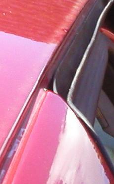

Passxantia_v6 wrote:Jim,
If you haven't used roof bars, then the holes have been there for a long time. Why only leaking (and so enthusiastically) now?
It has been raining VERY enthusiastically here in the last week though
I think the reason is that the top of the rubber door gutter worked itself away from the bodyshell and there was an eighth inch gap between it and the edge of the roof on the leaky side whereas on the dry side, the gutter was hard up against, thus helping the seal.
Compare the LH (leaky) gutter
With the dry RH one
See the big gap on the LH one. It also had a lump of moss from the garage roof jammed in it, making the problem worse.
I put it down to age and hardening of the rubber as the initial cause.
I hope that's the cause of the leak. If not then I'm all out of ideas...
