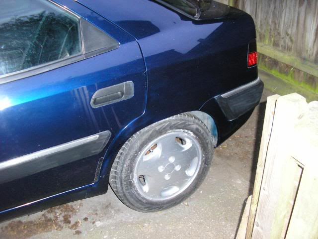

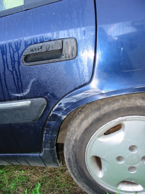

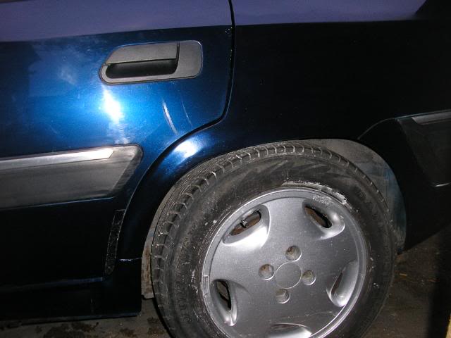

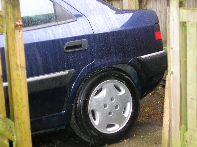

I have managed to replace 2 tyres and do the repair to the n/s/r door and wheel arch not a professional job :oops: :oops: but it looks ok from a distance (feet not miles :lol: :lol: ) and managed to get the door check strap sorted.
Picture of damage prior to repair
Pictures after bodge repair :lol: :lol:

Admiral doesn't look too bad to be honest, much better than what i could achieve, Im sure the resident paint guru will be along soon to cast a proper 'eye' over it though but still looks good :)

KP wrote:Admiral doesn't look too bad to be honest, much better than what i could achieve, Im sure the resident paint guru will be along soon to cast a proper 'eye' over it though but still looks good :)
Hi KP
Thanks for the confidence boost but i know its not right best i could achieve with an aerosol in the outdoors :oops: :oops:
tried hard to get it right but made the mistake of doing it late afternoon and when id put the laquer on i overlooked next doors overhanging tree and all the "bits" landed on the car and the sap/something has played havoc with the clear coat looked quite good when i finished it looked terrible in the morning but i could be being over critical :twisted:
Hopefully Gareth will cast his critical eye over it and be gentle(ish) with me :lol: :lol:

Unless you're well practiced, you'll never get it like the pro's but it's 100x better than it was and I think that makes it all worthwhile. Well done.

Not bad at all... Arch looked pretty messy tbh. Try some t-cut to bring a bit of shine to the lacquer, being aerosol it will need regular coats of wax to keep its shine, it also wont be fuel resistant and its softer than 2k so it may chip up quite quickly...
Been busted should have gone to an expert :lol: :lol: tried my best and failed miserably.If only i had the cash Gareth then you would be at least £500 better off (being cheeky im including the wheels :) )

I said it 'looked' not 'looks', past tense :wink: I think you done a pretty good job if you have no experience, there are a number of lines in that panel.

TBH it doesnt really stand up to close inspection paint finish wise but the body repair bit looks not too bad.Thanks for the tips on getting the best out of the finished paint 8) 8) :D :D
