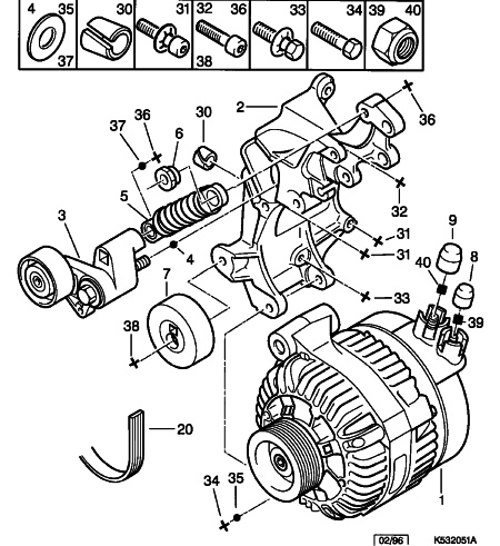

A slightly more urgent repair is now required - it spat a pulley off and I lost hydraulics and alternator about a mile from home. As I rolled to a stop, said pulley rolled up alongside me and was damn hot when picked up. It's got a big hole in the middle
I guess the motorway miles I did the other day going to view the C5 in chichester (it was a lovely run btw) finished it off as I was pushing hard on the return journey. The next morning on startup it sounded worse and I knew failure was that much closer.
Just waiting on a mobile mechanic to recover it now as it may still be saveable/repairable for little money. Not sure if I can cope with doing the repair myself though.

Re: Latest purchase blog
Sorry to hear that
What pulley Mike?
Crank pulley? If so, did it separate at the rubber bit?
If so, easily fixable. It's if the whole shebang fell off, as in your old white car, that things might be different..
What pulley Mike?
Auxillary concentric pulley (thankfully). Loss of hydraulics and alternator made pulling over safely an experience I'd long forgotten.CitroJim wrote:Sorry to hear that
What pulley Mike?
No7 (or 38?) in your pic
When recovery turned up I only then realised I don't have a tow hook (or I've never seen one if it's secreted somewhere (like the spare tyre cage crank is) so I had to drive it up the ramps to get it on and vice versa to get it off. Was a good test of my handbrake.
Now, can I get away with a decent used replacement seeing as I don't intend to keep the car or should I lay out loads of cash and replace both pulleys and belt with new parts?
