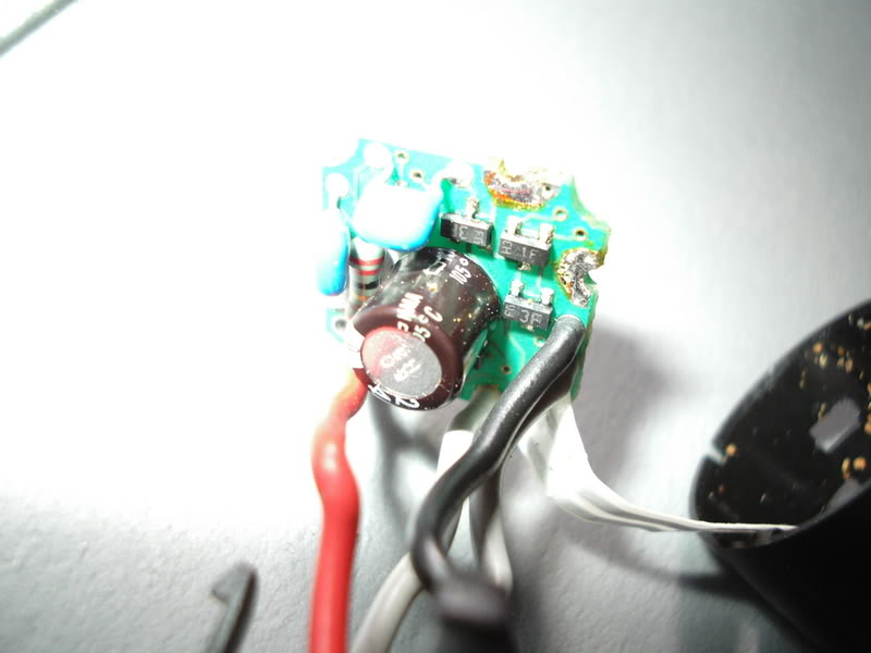

The motor isn't directly powered by pins 3 & 4, they go into a small pcb mounted on the base of the motor.
Do brushless motors require a controller or can voltage be applied as per a brush motor?
Is this pcb a generic brushless motor controller or is it an add-on which can be bypassed? I assumed the latter but that's because I don't fully understand brushless motors feed requirements.
The motor itself has four terminal legs and these are soldered to the pcb. If I can apply voltage directly, which of the four do I use?

Hi Richard,
I had to read it twice and it seems they do utilise a controller - I'm not clever enough to understand the logic of it all though.
Presuming the controller is integral to the motor, I'm hoping I can source a direct replacement brushless motor.
If it's a non-standard motor, I'll see if I can bodge something small to fit in it's place.

Sounds like a contradiction for my simple mind - is there or isn't there an electronic controller required for brushless motors?Third : there is no elctronic control for the brushless DC fan motors. Its build in behind the blower blade rotor.
Yes, 3 caps, one resistor and a sprinkling of surface-mount components but the power (+12V & -12V) for the motor passes through this circuit (as well as the temp sensor) and becomes four outputs to the motor windings.What you see on the PCB is the temp sensor itself, and possibly a couple of radio interference decoupling capacitors.
Desoldered and waiting 8)With some fiddling it should be easy to move the pcb over to to new blower. Be prepared though that you must power up your soldering iron

Things are mixed up here.
To clarify :
Yes - a brushless motor needs electronics to run off a DCvoltage.
No - the standard commercial available computer blower fans needs NO external electronics.
The necessary electronic circuit is built into the fan itself. Thats why it has a relative large mid-section. That midsection is NOT only the bearing - but a tiny PCB with some transistors etc.
You will instantly recon if you break the old fan apart.
(you will find a tiny axle C-lock ring under the paper label on the fan)
Now for the Xantia genuine blower circuit : I recon from Clogzz's kindly submitted schematics, that appearently there is some kind of external electronics circuit for the sensor blower fan.
However that can only be some kind of a voltage regulator, presumely a switcher or a square wave pulser, to omit any serial power loss (heat) from a standard linear voltage regulator. That would instantly upset the temp sensor readings
It also explains the "interference" capacitors, as pulsed voltage is a source of radio interference.
Conclusion is then, that the external electronics circuit is there to lower the drive voltage for the fan, to make it run slower, more silent and last much longer.
That is valid for the temp sensor blower fan ONLY
On the other fan circuit its noted that this is the "ventilateur chauffage" i.e. the cabin heater blower - on which we want to set the speed by choise.
So thats why its shown with a different kind of electronics circuit & more connections. These connections go to either the computer for automatic climate control, the ventilation panel knob control settings - or both.
Hope this is some light in the dark
NOTE : please do not reverse the fan voltage, some cheaper types dont even have a series protective diode built in

Ok.AndersDK wrote:Things are mixed up here.
To clarify :
Looking at the parts I have, I can't see any circuitry in the motor at allThe necessary electronic circuit is built into the fan itself. Thats why it has a relative large mid-section. That midsection is NOT only the bearing - but a tiny PCB with some transistors etc.
This is a picture of the assembly consisting of a two-piece plastic housing. The plug wires going through the smaller housing (red, black & 2 grey) are soldered direct to the pcb. A thin connector strip carrying the temp sensor wires go left into the larger housing and connect to the thyristor (just out of shot) on a strip board.
The motor is soldered to the pcb via four pins at each corner. This is it desoldered and the rotor removed.
Inside the motor we can't see any electronics.....
Now I'm really confused
On the schematic from Clogzz its shown to be only 2 wires running to the electronics - and from the electronics on to the motor - still only 2 wires.
On the schematic it only shows a DC motor running off a constan supply AND the sensor with one wire connected (other side of sensor is grounded via a mounting screw - MUST be)
For the temperature sensor blower motor
Is that really the small buzzing temp sensor motor off the airduct you've got there Mike ?
If so - then I'm completely off track now - as I was convinced it was the type found in computer equipment.
Anders (DK) - '90 BX16Image
Ahhh ...
Wait a minute.
There are 2 wires for the motor - and 2 wires for the sensor. As this is apparently a later modified type with no chassis fixing screw. There is absolutely no electronics involved in this variant either - despite the schematic.
The motor is a fairly standard DC motor, no electronics needed.
The sensor would be that "dingy" located separately on the small long strip of PCB, because thats where the airstrem comes from the running motor.
So what you need is still a small standard DC brushless motor as found in PC's. You simply connect a series resistor in series with the one motor lead then, to bring down motor speed and noise.
Be sure the resistor is out of the way of the airstream past the sensor, as it may influence the sensor reading.
You will need a 33 ohms resistor in series I think to bring down the motor speed. If the motor wont run, you must choose a lower ohmic resistor (27 or 22 ohms). If the motor howver still runs noisy you need a higher ohmic resistor (47 or 56 ohms). Resistors must be at least 1watt rated. Only a few pence each in Radio Shacks or Maplins
Wait a minute.
