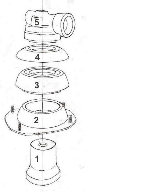

i might be wrong but the only prob i can see with these strut tops is,
if you look at the one in the picy the guys thumb is pointting at, it looks like they weld 4 piece's of metal across from the domed section to the mountting plate,
the original make up of these strut tops there is two separate metal components bonded together by the rubber, this is to firstly give a bit of flex and secondly to help absourb road noise,
regards malcolm

There is welded additional metal, but there is enough of elastomer between both parts, ensuring flexibility.

if you weld the conned section to the mountting plate there wont be any flexabilaty (elastomer),

Im not sure what do you mean by mounting plate.
Original construction:
1. The inner steel cylinder which sits on the strut.
2. The main clamping plate - the part which normally rusts and fails.
3. The solid rubber block that connects parts 1 and 2 together and will eventually/inevitably fail.
4. The steel dish.......
5. The top section which houses the hydraulic connections
In original the outside diameter of the bottom cylindrical part metal (#1) is 86 mm and inside diameter (hole) of cone/clamping plate (#2) ~88,3 mm so parts split (slide out) when rubber tears. So we eliminate this gap by welding additional metal rings on both parts and cylindrical part diameter becomes bigger than cone plates inside diameter. Still between metal parts there is enough of elastomer which provides elasticity. Elasticity tested by hand and on a road.

i always thoughgt 1 and 5 to be one piece, but even if the are not you are welding 1 to 2 which would originaly be bonded by the rubber block, and this would be what gives the flexabilaty,
