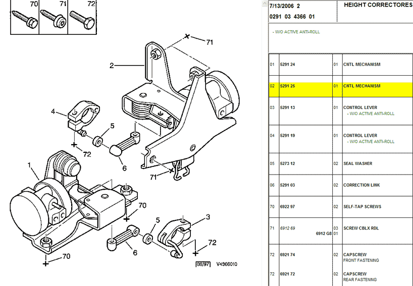

I had a good look just now... it's the link from the plastic clip that hooks onto the clamp on the anti roll bar, so there is no link at all from the anti-roll bar for auto adjusting speed, or the height selector lever, it was the next point of weakness after the plastic clip which was cable-tied on so securely. So I guess the height corrector seized up and the link snapped.
I think I will go see how much it is.
But in the image, which one is the front one? the one with number 3 or the one with number 4? And I assume the link comes with the clamp?
Thanks
Thanks

deian
- Posts: 1729
- Joined: 26 Feb 2006, 10:53
slim123
- Posts: 377
- Joined: 20 Jul 2006, 22:49
