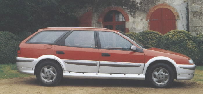

I think they did look into it, I've seen a photo

found one of them:
edit:
Found the rest here's the link:
http://www.kolumbus.fi/perhe_pitkanen/xw/styling.htm

Post by deian »
whoa check the link out, coupe and a convertable, so cool, a 4x4 v6 coupe would have kicked ass!
