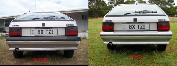

As regards the car, take a look at the rear of the car as it was and as it is, so it's a job that can have spectacular results. If you take a close look at the RH side you'll see the dent I took out; it was much nastier than the pic showed. I used a heat gun a piece of shaped wood and filler and then sanded, spray puttied and painted it in two pack.
