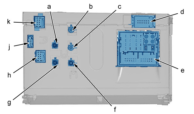

Here is a picture of the NG4 backside. Would you be able to identify where the unit should normally be connected to the CD changer ? I guess that it has to be activated using a diagbox as well ?

The NG4 has telephone Bluetooth as you probably know, but will not support streaming music from any device. If you are planning on using a Yatour or similar to mimic the CD changer - bear in mind that will still be limited as it is only mimicking the CD changer, so you will have limitations to what you can do.
It's ok, I don't need the images of the rear, I have these already.
The connection you need is shown at 'E' below. Within Connector 'E', there is a separate block 'C'. This contains the connections for the CD Changer. Below are the pin assignments.
Part "C": 12-way black connector (*)
Furthermore, you may still need to activate the function in the BSI using Diagbox to enable it. Bear in mind the CD changer connections shown above are CAN enabled - so it is possible that the Yatour or other device may not be compatible with the electronic architecture in the vehicle.

You understood it perfectly well : my plan consist in mimicking a CD changer to install a Phibu BT module behind my Wipcom3D. Two kinds of modules can be bought but the only one that keep most of all the steering wheel commands active (VOL +, VOL -, FF, FR) has to be pluged on the CD changer connector. However, this module won't be able to display any tracks listing or titles on screen (which I don't mind). Guess that I will have something like "CD changer #X" on screen instead ( ).
Here is the french webpage that sells the module I'm talking about. The module is sold as RD4 compliant so it will be CAN compatible.
https://www.phibu-electronics.com/nouve ... 2x34599710
According to your explanations, I'll have to use the 12 pins type #1 connector (wich is oriented) on the separate C block of the picture above.
Last step : activate the CD changer option using a Diagbox
I think that I'm correct here.
Btw, what are the other connectoers on the WIPCOM3D for ?

The other connections are:
"a" Aerial FM2.
"b" Aerial TV2 (for Japan only).
"c" Aerial TV1 (for Japan only).
"d" MQS cable connector.
"e" 3-part connector.
"f" GPS aerial .
"g" Aerial FM1/AM.
"h" LVDS 2 cable connector.
"j" USB socket connector.
"k" LVDS 1 cable connector.

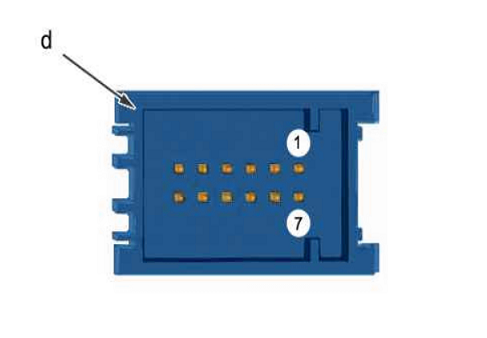

Do you have a detailed plan for connector D? I guess that there some of them AUDIO L R and VIDEO

Here you go:
Micro Quadlock System Conenctor 'd'
Channel number | Allocation of channels of connector |
1 | Audio signal + (Service module) |
2 | Audio signal - (Service module) |
3 | CAN High |
4 | Channel not allocated |
5 | Channel not allocated |
6 | Channel not allocated |
7 | Channel not allocated |
8 | Channel not allocated |
9 | VAN Low |
10 | Channel not allocated |
11 | Channel not allocated |
12 | Channel not allocated |

Could you share the details for connector LVDS H & K

Here you go.
"h" LVDS 2 cable connector (10-way)
"k" LVDS 1 cable connector (10-way)
