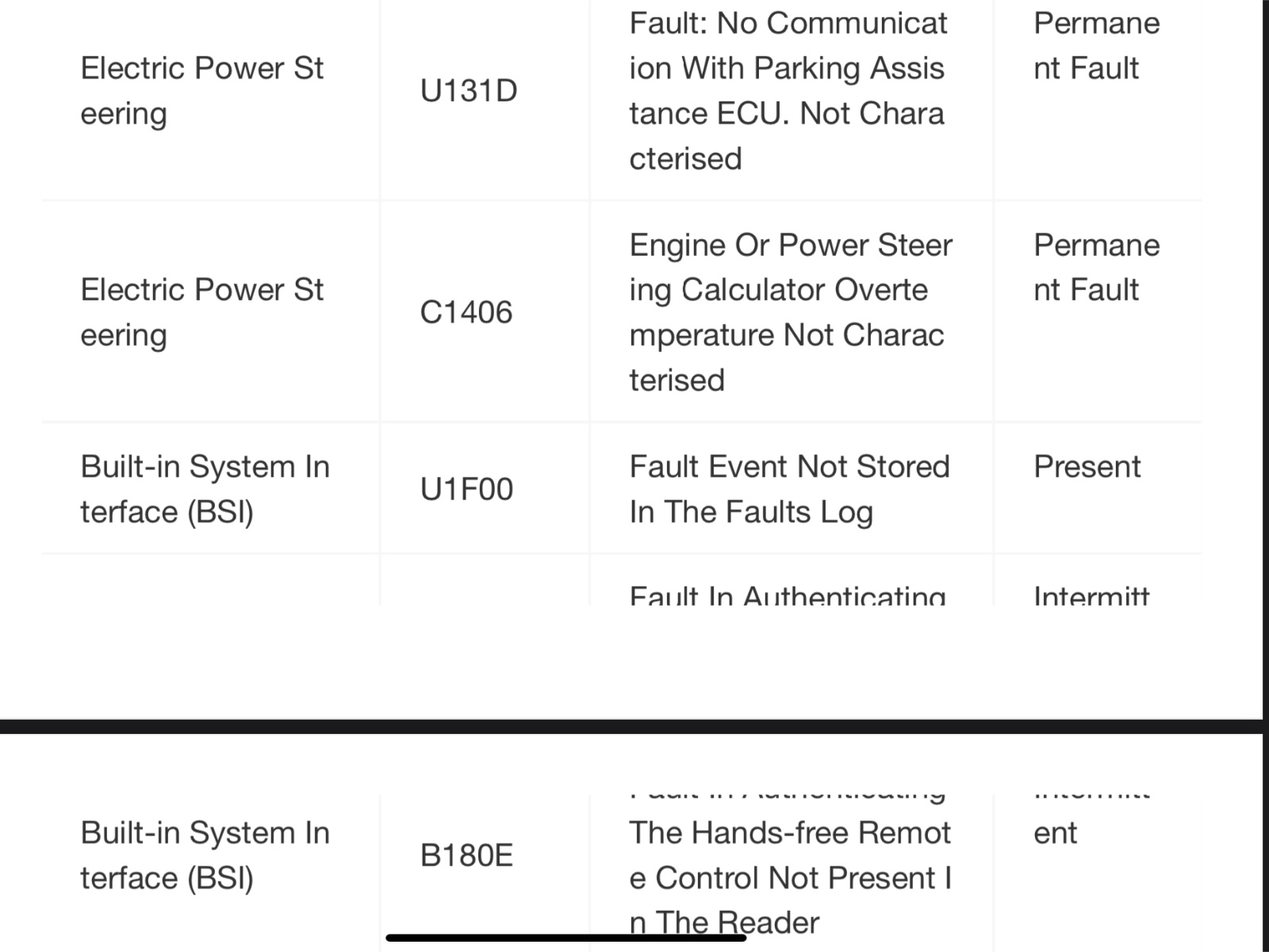

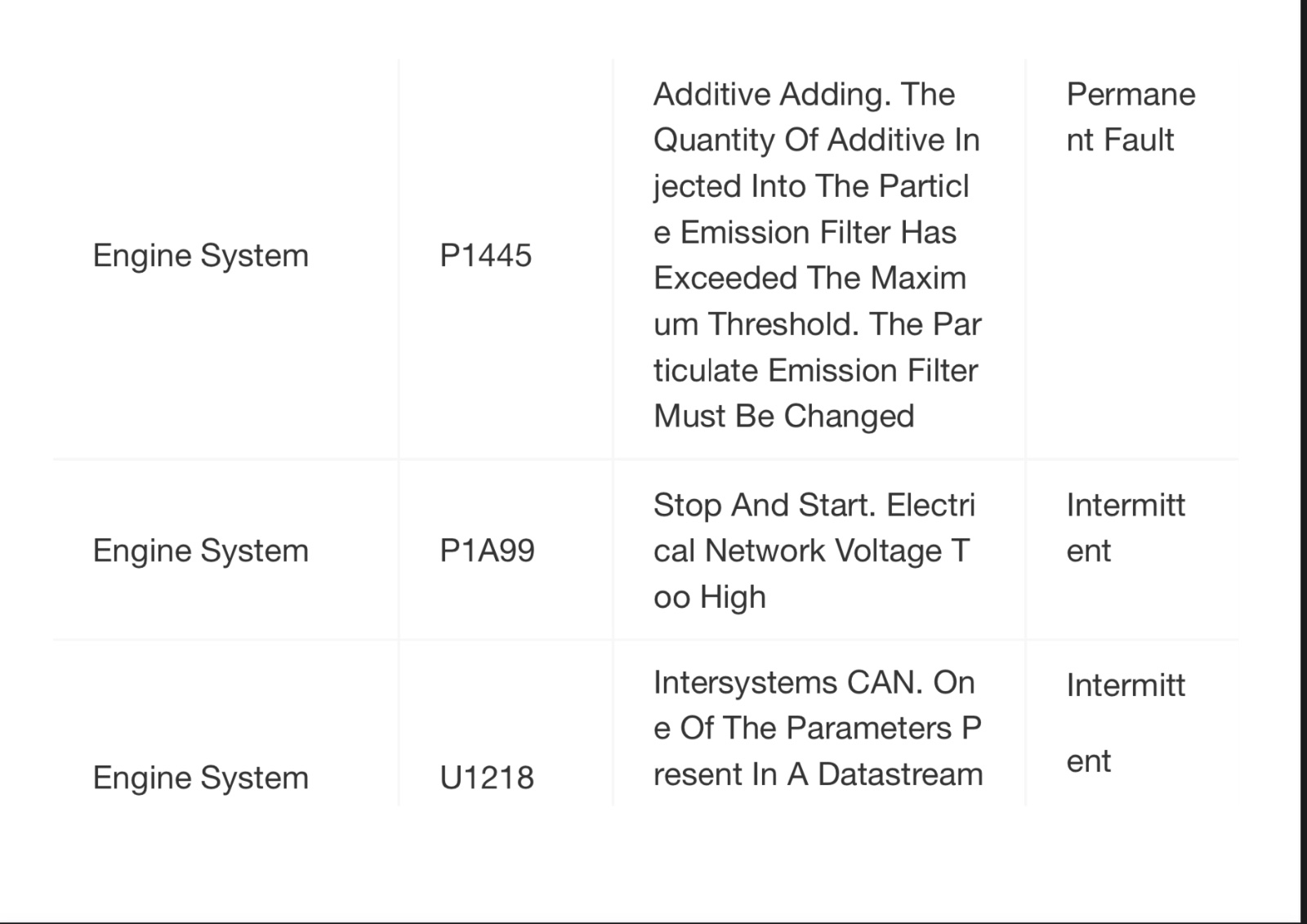

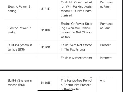

i m new to this forum. recently I bought used Citroen C4 GP exclusive plus 2014 . since i bought this car I m getting different type of faults on it. through this forum , I solved most of faults. currently following fault code I m unable to clear or solve them. These fault codes i got from Topdon arti800bt scan tool.
can anyone help to solve these faults.

P1445 means the computer thinks the DPF is end of life. Chances are that it is still OK pressure wise and regenerating, so you can just tell it it's been replaced and it will be happy.
Not sure about the power steering ones - you'll need to get into the live data and see if anything looks amiss - but these are electric power steering, it may well be that it needs a new rack...

thanks for reply. recently i did regenerated with Topdon and it was successfully completed. i will try to get live data.RichardW wrote: ↑16 Jul 2023, 08:36 P1445 means the computer thinks the DPF is end of life. Chances are that it is still OK pressure wise and regenerating, so you can just tell it it's been replaced and it will be happy.
